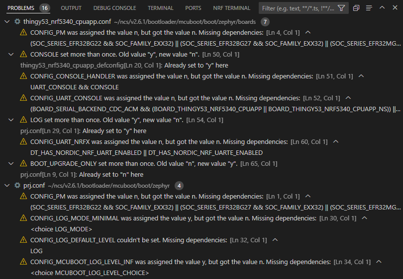

Many warnings when building the Matter weather station sample
When building the Matter weather station sample, without any changes, I see many warnings regarding incorrect project configuration, such as conflicting options or missing dependencies.
Is there an issue on my end?
This sample was built as follows:
  • A new nRF Connect SDK install on Ubuntu
    • Toolchain v2.7.0
    • SDK v2.6.1
  • VS Code
  • nRF Connect Extension for VS Code
  • Using the nRF Connect Extension "Create a new application" to create the Matter light bulb sample project
  • Project is configured for Thingy53
Thanks
Parents Reply
    Apologies for the wait. I've just heard back from the team who's created the application and they said that unfortunately there are still a couple of unresolved warnings (those we both see), and that there is an internal task to resolve them. I don't have a timeline for when this will be fixed, unfortunately.
    However they should not impact the code, so you can still use the application as a template/starting point when developing and clean up the warnings as desired.
    Andreas
