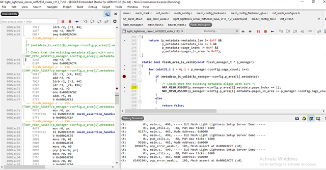

After DFU update, device fail to initialize mesh stack configuration
Hi, I am using light lightness server example for the testing of DFU OTA over mesh. I have successfully transferred the DFU archive over serial with nRF Util tool and follow the steps as described in the nrf5 SDK for mesh. After DFU update device restart and return "app_error_weak.c,  105, Mesh assert at 0x0002AC42 (:0)" when initializating mesh stack.
This is light lightness example with DFU functionality:

  • Hi Terje
    addr2line shows assertion is trigger from file flash_manager.c  line number 255.
    Please find attached image:
    Danish Riaz
    This error indicates that a Flash page used by Flash manager is corrupted. This may happen in a few different situations:
    It may happen if the flash configuration differs between the old and the new application. This could be that the flash area locations differ between the two versions of the application, or that the defragmentation recovery page is located at a different flash page.
    It may happen if the new application is larger than the old one, and the new application overwrites parts of flash pages previously used by flash manager. Those pages could have been outside of the application flash before, but now are inside the application flash space and therefore now holds part of the applicaiton instead.
    It may happen if during the firmware transfer, the bank for receiving the new applicaiton overlaps with pages used by the flash manager.
    If I recall correctly it could also happen if the bootloader itslef is updated, but for some reason the new bootloader is larger than the previous one. However this should not normally happen and so this is less likely to be the cause of the error that you see.
    Terje
