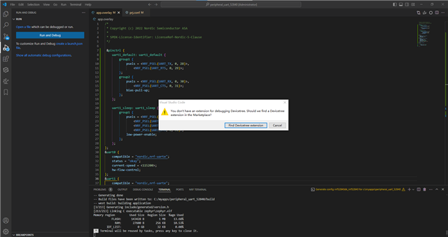

    Using the configuration file and overlay file you gave me, I still can't get peripheral_uart to execute as host. However, when the program flash to the development board, the situation changed. The original program will cause all 4 leds on the 52840 development board to light up, according to the program, this is the process into the error cycle. Now, all four leds are out, indicating that the program is not being executed correctly.
    In addition, when these two files are modified, my debug program cannot execute normally, VScode feedback information as shown in the following figure.
    (PS:In case the picture is not clear enough, the relevant text excerpts in the picture are as follows: You don't have an extension for debugging Devicetree. Should we find a  Devicetree extension in the Marketplace? )
    Please try to check the log (RTT log or UART log).
    Have you made sure you connect the controller board to the right UART pins ? I used P0.28, P0.29, P0.30, P0.31 for the UART connection.
    The 4 lights turn off most likely because it's no longer assert with uart_init but it can't communicate with the BLE controller board.
  • I have verified that my pins are connected correctly. I conducted tests using the same configuration file and overlay file as you did, with no other changes made. When using the serial assistant on PC to capture the TX pin of uart1, I found no output information. My suspicion is that bt_enable() is not being executed effectively. Do you utilize the aforementioned files in the peripheral_uart routine to enable communication between host and controller? Have there been any additional modifications to either the host or controller?
    In any case, my objective is to troubleshoot why debugging isn't functioning so that I can identify and address the issue.
