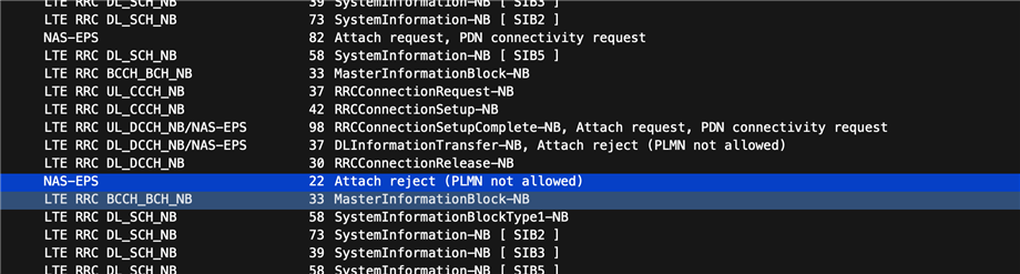

  • The firmware support both networks so it is not a problem. Converting the modem trace to pcapng file with Cellular Monitor and open with Wireshark.
    I found the devic is rejected by the network with EMM cause 11.
    Cause #11 – PLMN not allowed
          This EMM cause is sent to the UE if it requests service, or if the network initiates a detach request, in a PLMN where the UE, by subscription or due to operator determined barring, is not allowed to operate.
    Please double check with your network operator if you have a valid subscription, and you have correct PDN if it needs to be set.

  • I'm trying to figure out why it's not connecting to the network, the ISP says the SIMs are fine. When I try using Modem Shell to connect manually, I'm getting few errors. It would be great if you can help me connect to the network. Please check if the way I'm adding APN details are correct. I have attached the trace file of the Modem Shell, hope that helps.
    mosh:~$ > link connect --apn "airteliot.com" -f 'ipv4v6' -A 0 -U "" -P ""
