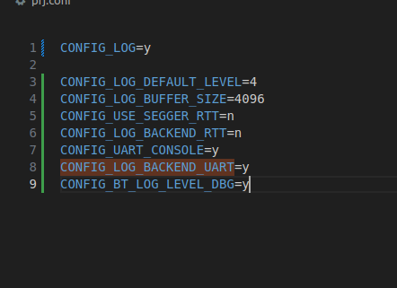

Prj.conf:
CONFIG_LOG=y
CONFIG_LOG_DEFAULT_LEVEL=4
CONFIG_LOG_BUFFER_SIZE=4096
CONFIG_USE_SEGGER_RTT=y
CONFIG_LOG_BACKEND_RTT=y
CONFIG_LOG_BACKEND_RTT_OUTPUT_BUFFER_SIZE=1024
CONFIG_UART_CONSOLE=y
CONFIG_LOG_BACKEND_UART=y
CONFIG_BT_LOG_LEVEL_DBG=y

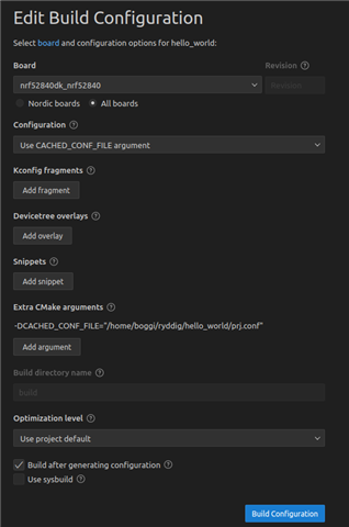

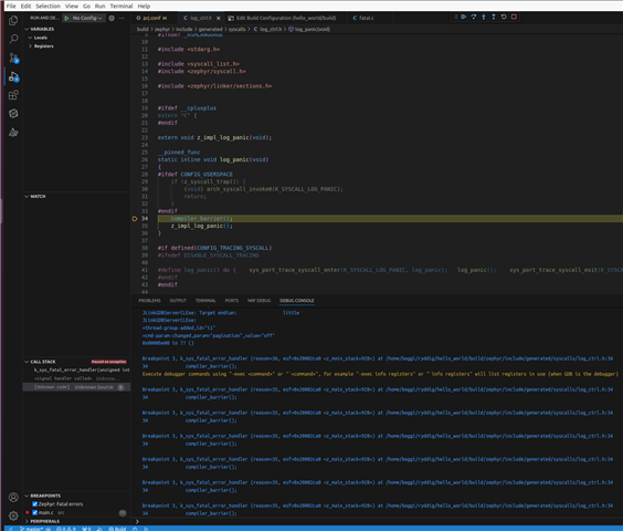

However it crashes:
Terminal only gives:
00> [00:00:00.000,000] <err> os: ***** BUS FAULT *****

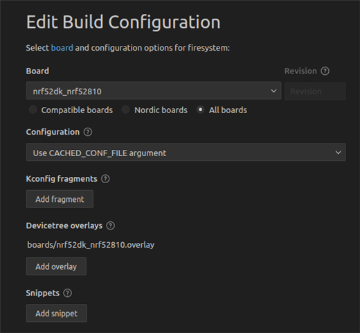

Build config:
I am using the dev nrf52DK,
When using debugging it crashes before entering main.
