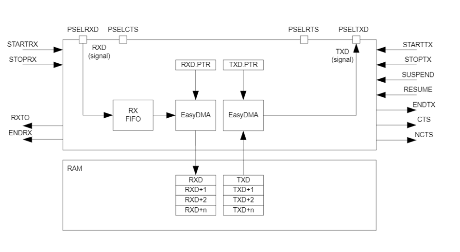

I used SDK 12.2. Product was developed some years ago and now I am working for upgrade. One of new features is UART. I faced very strange problem.
I send 14 bytes from PC via FTDI UART 3.3V cable to Nordic and Nordic send back different 14 bytes to PC.
This process repeats each 200 ms
Baud rate 115200 no flow control, no parity

I get sometimes event APP_UART_COMMUNICATION_ERROR error_communication  = 1
It happens randomly. May happen.  immediately or after 2 bytes received or after 6 bytes received
As I understood this value is the same as in register ERRORSRC. Is it correct?
How can I prevent this situation? I put interrupt to highest priority, use easy dma and fifo and despite all this it happens.
What''s wrong? Please help

    The EasyDMA does work correctly and has nothing to do with this error. The overrun error is caused because the peer is transmitting data even after the RXD buffer is full in your nRF device and since you have disabled flowcontrol, there is no way to communicate this with the peer.
    This issue is happening because you have disabled flow control and using high baudrate. Do not focus your energy assuming that this is a hardware issue. Just reconfigure your firmware to enable flow control and/or reduce the baudrate and you will not see this error. The overrun error is working proper and this is how the UART works.
