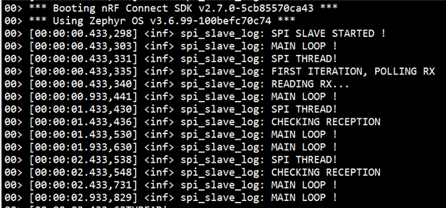

The issue is that the done signal is never raised and that the thread is paused indefinitely after 2 executions :
It seems to be a problem with a semaphore never released.
I may be lacking of understanding of the transceive_signal functions. I read the documentation about it but I'm not sure that I'm using it the right way to achieve what I want here.

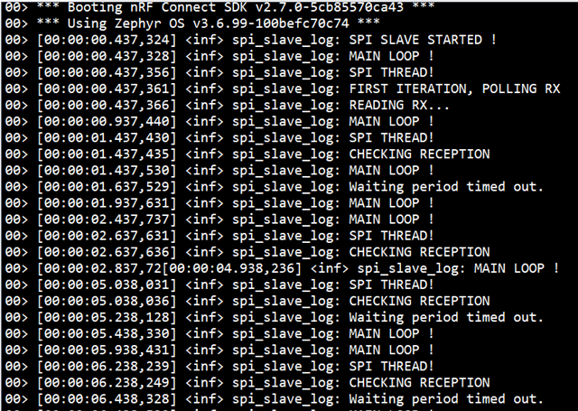

    When I execute this code, I have the following logs :
    So my problem here isn't a paused thread but the k_poll_signal_check that never returns true.
    The documentation about spi_read_signal is not really detailed. But I assume that the k_poll_signal should be raised whenever a transaction is done ?
    PS : I have a master connected that pushes messages periodically.

  • I introduced the EVENT as follow :
    static struct k_poll_event async_rx_evt = K_POLL_EVENT_INITIALIZER(K_POLL_TYPE_SIGNAL, K_POLL_MODE_NOTIFY_ONLY, &spi_rx_done_sig);
    And modified the periodical function with :
    int8_t drv_nrf_msg_check_u8(){
    	LOG_INF("CHECKING RECEPTION");
    	rx_raised = k_poll(&async_rx_evt, 1, K_MSEC(200));
    	if(rx_raised == -EAGAIN){
    		LOG_INF("Waiting period timed out.");
    	/* Reinitializing for next call */
    	async_rx_evt.signal->signaled = 0U;
    	async_rx_evt.state = K_POLL_STATE_NOT_READY;
        return(rx_raised);
    The log here is :
    So yeah basically it seems that the event never happens. I may be doing something wrong with the usage of spi_read_signal.
