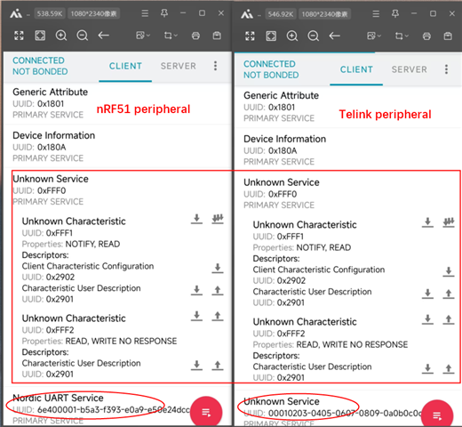

nRF52832 central primary service discovery not found
HW: NRF52832 DK
SDK: 17.1
SD:S132_7.2
Sw: ble_uart_c

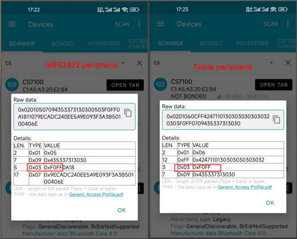

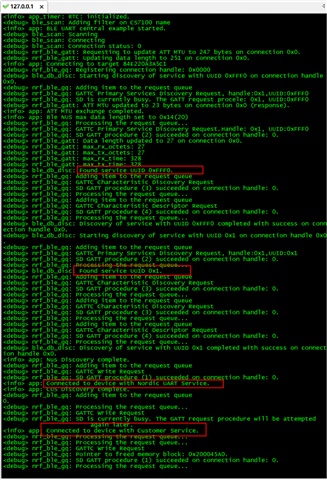

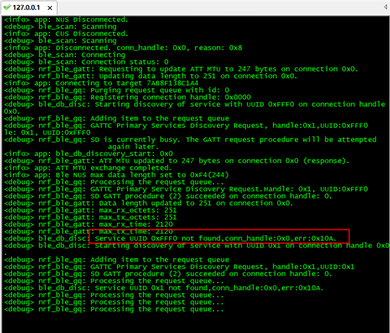

Issue: nRF52832 as a central to scan a peripheal(not nordic chip),the nRF Connect APP can discovery all the service, but in nRF52832 it can not disovery the primary service.I attched the peripheral service pincture.  It have two customer service, 0xFFF0 is the primary service i want to discovery.And attched the log when discovery start.It always respond 0x10A error.
And i tried a nRF51822 board as ble peripheral, the central can discovery the primary service successfully.As follow picture shown.
But same cental code can not discovery the primary service.I attch the code modified in SDK example ble_uart_c.Please help me!Thanks!

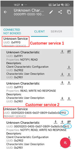

  • Hi Simonr:                                                                                                                                                                                                                                  Maybe i have not describe my problem clearly. I want to connenct  the telink peripheral, and i just want to communicate with customer service 1(0xFFF0).The customer service 2 is just for OTA. So is the nRF52832 central need to discovery the service 2 at the same time?
          I have added two customer service in the nRF51822 peripheral, and nRF52832 central also added the two customer service discovery.I can discovery the two customer service successfully.As below:
         But when  i switched to the telink peripheral, the nRf52832 central can not find the customer service 1.AS below:                                                                                                                                                                                                                                                                                                                                                                                                                                      Because i do not konw how to modify the last 16 bit UUID based on 128Bit(As the picture1 shown) in nordic chip, so i did not modify the customer service 2's UUID in nrf51822 peripheral at same with telink peripheral. I do not think customer service 2 will effect the discovery result of customer service 1.
                                                                                                                                                                                           Why the nRF52832 central can find the service FFF0 of nRf51 peripheral, but not find the serive FFF0 of telink peripheral?  Please helo me solve this peroblem!Thanks!
  • Hi Simonr:
    The log of nRF52832 central discovery the NRF51822 two customer service succssfully was wrong.Please see this:
  • Hi Simonr:
    I also upload the wireshark sniffer log of nRF52832 connect to the telink peripheral.telink.pcapng
    In the sniffer log, the SD response error when the handle is 0x0001(it just the start handle),the SD not serach form 0x0001 to 0xFFFF.But when i switch to nRF51822 peripheral, i will get the SD response found FFF0 service at handle 0x0009.
  • Hi
    I think this is due to the 16-bit offset in tohe 16 bit UUID, where you don't use the first 4 bytes, but the ones after that for discovery as described in this thread:  Received service discovery response . Service discovery failed . Error code 0x10A
    The nRF51 is probably handling this already, while the Telink peripherals most likely are not. See this case where that was the case in a previous post. If that doesn't help, please share some more details about how the service is set up on the Telink side.
    SImon
