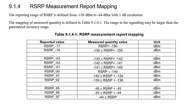

there seems to be an overlap problem for rsrp and for rsrq in documentation and code comments
* RSRP.
* * -17: RSRP < -156 dBm
* * -16: -156 ≤ RSRP < -155 dBm
* * -3: -143 ≤ RSRP < -142 dBm
* * -2: -142 ≤ RSRP < -141 dBm
* * -1: -141 ≤ RSRP < -140 dBm
* * 0: RSRP < -140 dBm
* * 1: -140 ≤ RSRP < -139 dBm
* * 2: -139 ≤ RSRP < -138 dBm
* * 95: -46 ≤ RSRP < -45 dBm
* * 96: -45 ≤ RSRP < -44 dBm
* * 97: -44 ≤ RSRP dBm
* * @ref LTE_LC_CELL_RSRP_INVALID : not known or not detectable

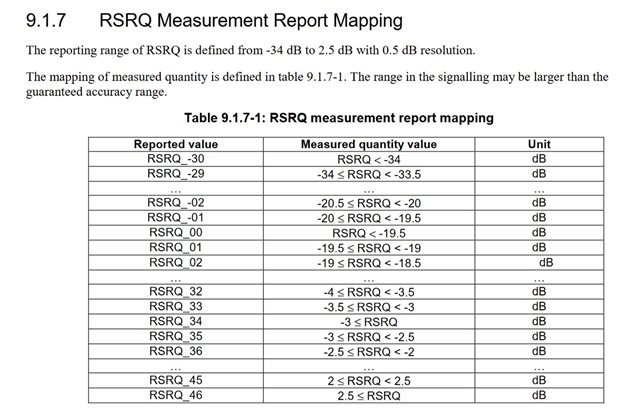

* RSRQ.
* * -30: RSRQ < -34 dB
* * -29: -34 ≤ RSRQ < -33.5 dB
* * -2: -20.5 ≤ RSRQ < -20 dB
* * -1: -20 ≤ RSRQ < -19.5 dB
* * 0: RSRQ < -19.5 dB
* * 1: -19.5 ≤ RSRQ < -19 dB
* * 2: -19 ≤ RSRQ < -18.5 dB
* * 32: -4 ≤ RSRQ < -3.5 dB
* * 33: -3.5 ≤ RSRQ < -3 dB
* * 34: -3 ≤ RSRQ dB
* * 35: -3 ≤ RSRQ < -2.5 dB
* * 36: -2.5 ≤ RSRQ < -2 dB
* * 45: 2 ≤ RSRQ < 2.5 dB
* * 46: 2.5 ≤ RSRQ dB

  • Hello again,
    So the overlap is a mistake. It unfortunately likely got that way when we slowly got support for lower and lower values. Thanks for pointing this out to us!
    When it comes to the behavior, it is likely a similar problem in the code and not just the documentation. So eg. either the value 0 or -1 is used for RSRP between -141 dBm and -140 dBm. In any case, this does not look like a big issue to me, as you can essentially interpret values 0 and -1 in the same way, right?
    Elfving
  • This should be fixed in upcoming version of NCS and MFW.
    Thanks again for the report.
    Elfving
  • Hello again Richard,
    Just a quick update. It turns out that the AT command specification follows the RSRP and RSRQ values specified by 3GPP TS 36.133 chapters 9.1.4 and 9.1.7. Because these values come directly from the 3GPP specifications, we’re most likely not going to change the AT command specifications or the LTE LC API.
    This might be an error in the spec. The way it’s currently specified is ambiguous. It is hard to know if this is intentional or not.
    Either way, like I mentioned earlier, this would must likely not be a practical problem. If you believe the way it currently is will turn into an issue for you and your application, please let me know.
    EDIT: Okay, there will be an update after all, but we are unsure about when it will be done.
