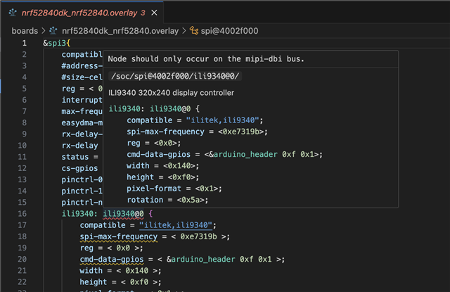

DevAcademy Intermediate Lesson 5 Exercise 2 build fails: Node should only occur on the mipi-dbi bus.
sdk v2.7.0
