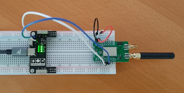

I´m working with LTE IoT 4 Click, by Mikroe, that use a nrf9160.
I need to connect to network with my modem, but i have some erros. My goal is to communicate with LTE or NB-IoT (preference for LTE).
When a trying to connect, my modem restart or not connect. I tested with basic examples: at_client, at_monitor and some samples provided for DevAcademy course, Cellular IOT Fundamentals.
My setup is:
Im using a nRF52840 to program my device. I want only use LTE, so i used a antenna by Digi: 76000926 (https://es.digi.com/products/models/antennas/76000926).

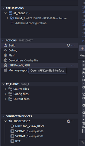

On the NRF CONNECT SDK, i`m using a nRF9160 DK NRF9160 Non Secure board:

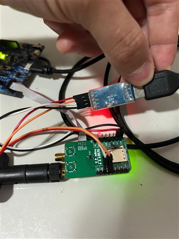

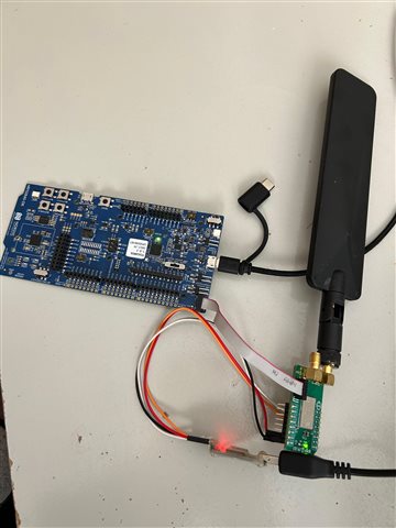

Im send and receive AT Commands from UART0 (TX=29, RX=28).
When i trying with NB-IoT, the connection was not made. When trying with LTE, the modem restart.
I believe that my SIMCARDs are ok because i tried in other modules (SIM7080G) and all is ok.

  • I use such a MIKROE LTE IOT 4 CLICK with success. Here in south Germany both works LTE-M and NB-IoT.
    I use also the nrf9160dk_nrf9160_ns board definition and add the mikroe specific stuff using an additional mikroe.overlay and also some mikroe-prj.conf. (The CONFIG_UART_RX_PULLDOWN=y is specific to my project, just skip it.)
    I'm not sure, what you use as power supply, it need to be a 3.3V one.
    And you may need to update the modems firmware to 1.3.6 as well.

  • Thank you very much for your reply!
    Im from Brazil. My power supply is 3.3V, come from TTL.
    I tried your suggestions, but the errors are still the same. Below is the sequence of AT commands and the returns for two scenarios: without the .overlay and prj.conf suggestions, and with them. Here ir my application: https://github.com/sluissantos/lte_4_click.
