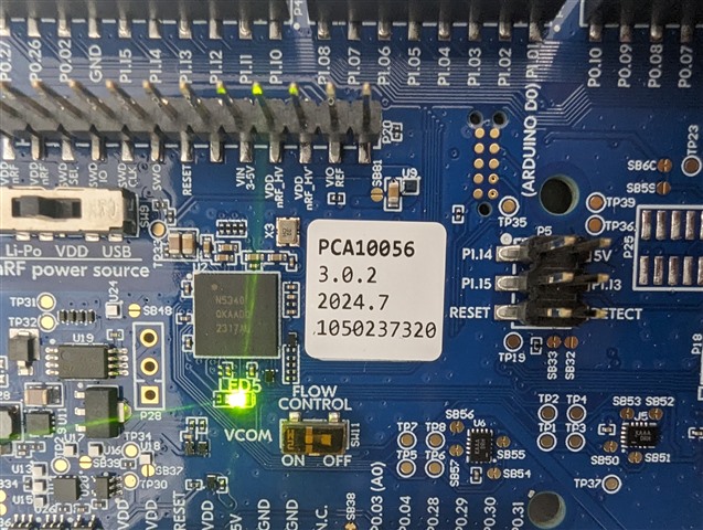

I have been using an nRF52840 dev board and a nRF5340 dev board to program Bluetooth demos. Just today my nRF52840 board became very difficult to flash I get the error,

I get this error roughly 90% of the time when attempting to flash an application to the board. There does not seem to be any rhyme or reason as to why the board fails to flash the application. I have tried to use the nrfjprog --recover command and this does not seem to improve the rate of failure. I reran the command with the --log option aswell and have attached the log. Additionally I have attached the log from running nrfjprog -f NRF52 -r --log.

    Thank you for the clear description of your problem.
    • Have you checked that the USB port hasn't been physically damaged and that the USB header is still firmly connected to the solder pads? It hasn't been loosened, has it? Sometimes this can happen if the USB cable is bent while it's inserted into the DK?
    • Can you go through the steps here and see if any of them fixed your issue?
    • What voltage do you measure on RESET, GND, and VDD?
    • Can you share a picture of your board that shows the sticker with version number?
    regards
    Jared
  • The USB port does not seem damaged. I used a new cable, I don't have a different computer to try flashing with. I don't have a volt meter to measure the voltage currently but I can get one next week. The board was working better for a couple days when I used an additional USB connected to power, but now the board will no longer flash an application. I have replaced the coin cell battery and that did not improve things.
  • I would like to fix this issue, but I am using the board to develop and demonstrate some Bluetooth functionality which is time sensitive for me. What is your policy on replacement / refund considering I purchased this board less than a month ago?
  • I am attempting to put the board in bootloader mode (Option 4 in the link you provided) but the board is not entering bootloader mode when pressing the reset button while powering the board on.
  • I have figured out the problem is not with the hardware or with JLink itself but seems to be with the SDK. When using the flashing option provided through the SDK in VSCode, I encounter the issue described in the post. However, when I use JLink through the command line I can flash the board without failure.
    So I have found a way to flash the board, but to any Nordic Engineer reading this there is an error with the flash functionality in the SDK. I have uninstalled and reinstalled the SDK and toolchain multiple times and the issue did not go away.
