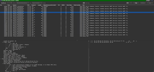

    Around same topic I can show you another log from my wife POCO x3 phone where you can see event 2642 here below:
    Lot of packet in the same event, this made me crash for low buffering I suppose, still sending from NRF toolbox...many many different behaviours, below the log of image, you will  see lot of tx before event 2642, that is sending a lot of tx inside.
    poco-crash.pcapng
    From my side of embedded board, can you confirm me that this variable hvv_tx_queue_size is the one related to the max number of packet I can bufferize on my side before getting no resources available?
