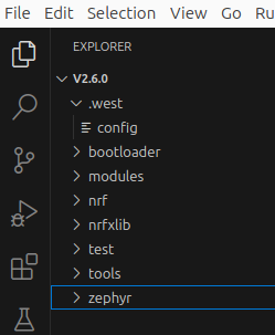

I had no problems installing V2.6 some time ago on the same PC (UBUNTU  24.04 LTS)
