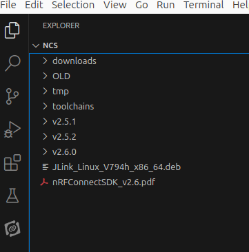

  • vorrias said:
    Nope, same problem even when ncs directory opened in VS
    I meant the other way around: there should be no ncs folder selected. Otherwise I believe it find one you have there and assume you just want to stick to that.
    I've tried installing it using toolchain manager on an Ubuntu 22 atleast now, with toolchain manager v1.5.1, and that worked fine. Could you try downloading the latest version of nRF Connect for Desktop in case you do not have that?

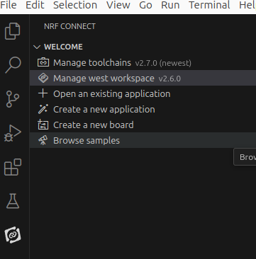

  • Yes it works now on Ubuntu 24 using your suggestion on
    1.Download it manually......
    Still on VS my second line is different than yours but may be something on configuration?
    Anyway I can work now on any Ubuntu.
    That solves the problem and hope helps others too.
