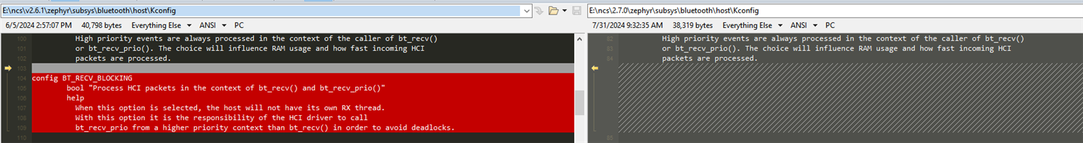

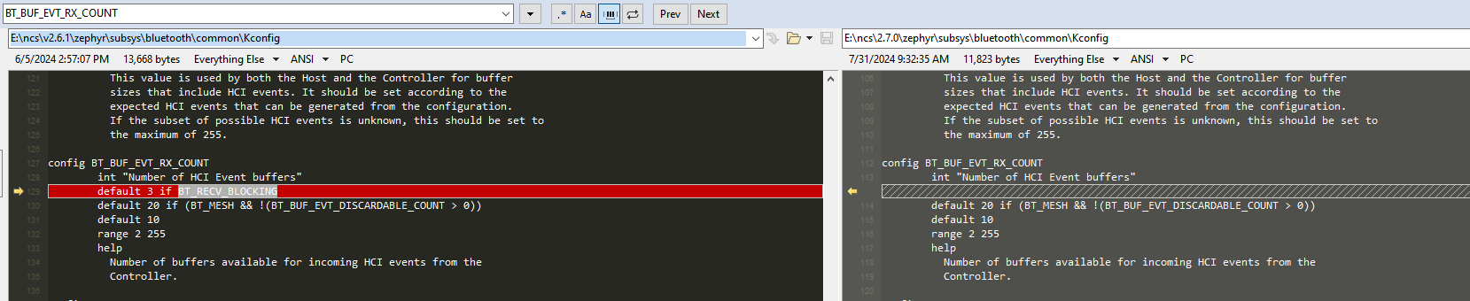

I am hit with a noticeable ram usage bump (~10%) when migrating from 2.5.0 to 2.7.0. Upon generating the ram_report, I notice that net_buf_data_hci_rx_pool has a huge ram usage increase (from 1.5k to 5k) while all of the BT configs remain to be the same. Therefore, I would like to know if there is anyway for me to reduce this amount. Thanks!
