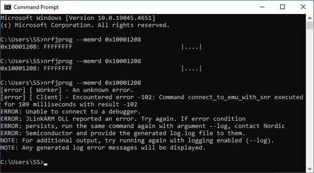

  • Hi Vidar,
    One last question on this problem -Does nrfjprog suppose to work only with Nordic DKs or as well with any J-Link hardware?
    Because I can run with my 2 nrf52* DKs but cant run it through my J-Link:
    Thanks
