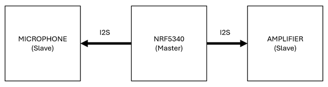

  • I would like to explain my application here and need to confirm if I can achieve this using nrf5340
    1) We will read data from Microphone using I2S
    2) Then, We will send the same data to Amplifier which is also connected through I2S
    (This process should not have any larger delay and we need live streaming of microphone data)
    Query:
    Can this be achieved using the below connection method. If not, what should be done to use this I2S with 2 channels
    is it not possible to just provide the clock signal, and wire the I2S data directly to the amplifier?
    I am not sure whether it works,please confirm me that,If yes will it achieve by using i2s_buf_write will be transfer to amplifier?
    Please note: Our chosen amplifier will act only as slave and it cannot give out its own clock signals to Microphone.
