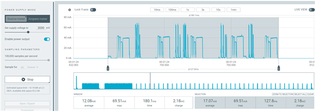

Iam trying to make an ble advertiser project on nrf52840 with nrf21540(custom board)
there are a few configuration changes required for the board(pins and supply voltage) which i have provided via an overlay file(nrf21540dk_nrf21540.overlay)

Now the issue is the power consumption of advertisement is very much higher than the same code's consumption when run on nRF21540DK,
power consumption of DK (note: the pic has both non.conn(coded_phy). and followed by conn. adv(legacy) repeated for 5 pkts at tx power +18 dbm)

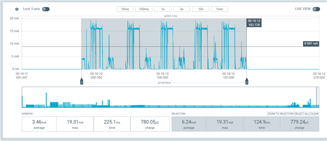

power consumption of my custom board (note: same as above but at +16dbm)
Is there anything that I'm missing that makes the difference in consumption??
I'm also unable to achieve the range compared to the DK(comparatively much lesser)

  • Have you measured the output power here (for instance using a spectrum analyzer), to ensure you have the same output power between the DK and your board? I am thinking if it's possible one is actually also transmitting at a higher power than the other. Though I am not entirely sure how that should be the case if you are building the same project for both boards.
