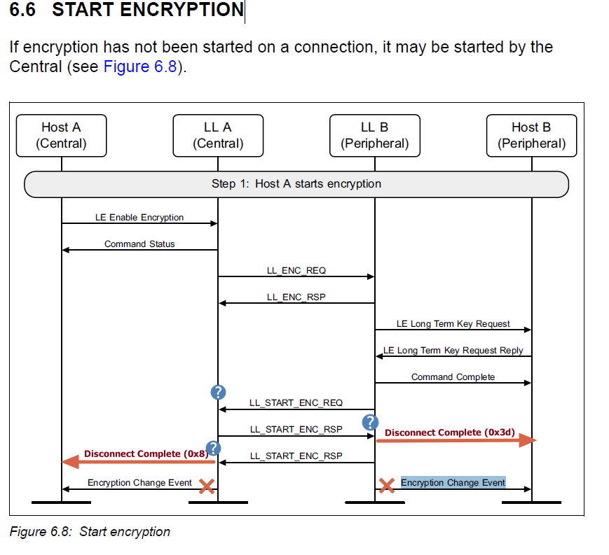

Hello Nordic Semiconductor tech support team,
HW : nRF52840 ( Build code : nRF52840-CKAA-F )
SW : ncs 2.6.0
Sample Application :  zephyr/samples/bluetooth/hci_spi sample with SoftDevice Controller
While verifying our software design, we frequently encounter connection errors. Could you help us identify the possible cause of this issue and suggest a resolution? Right after the enhanced connection is completed, we’re expecting an Encryption Change Event from the SoftDevice Controller. However, instead of an Encryption Change Event, a Disconnect Complete (0x05) occurs with the reason ‘Connection Terminated due to MIC Failure (0x3d).
Device A : Android Mobile Phone (central), (iOS case is also reported)
Device B: nRF52840 (Peripheral)

    I get slight impression that there is some marginally timing here or that the wrong keys ares provided.
    Do you see the same if you relax the SPI clock speed, and in specific if you relax (e.g. >10us for test) for instance the timing between slave select and first clock pulse.

    Thank you for your prompt response and update. Based on the HCI log from device B (nRF52840 SoftDevice controller), I have ruled out one possible cause: the wrong LTK case. During this test, we consistently used the same LTK.
    Could you please investigate this case from another perspective? Specifically, could you identify the scenario in which the SoftDevice Controller sends out the (0x3d) reason during a Disconnection Complete event, in collaboration with your BLE Core development team?
    According to our logs, the error occurred when the connection began encrypting immediately after it was created, rather than during heavy traffic to/from the SPI bus.

    Thank you for your patience. I received the sniffer log from the test team. This test case involves around 50 reconnection tests. I observed that 13 of them failed with the same pattern.
    	15,645		2	0xbc85f063	0x000a	LL_START_ENC_REQ		43	 00:00:00.097501125	8/16/2024 8:25:22.270591865 AM

    According to the sniffer logs, somehow the NRF52840 does not understand LL_START_ENC_RSP. For example, in the first failure, the LL of Device A (Mediatek, Inc., subversion: 0x0000) keeps sending LL_START_ENC_RSP, but there is no LL_START_ENC_RSP response back. Most likely, the NRF52840 determined that the Message Integrity Check (MIC) failed on a received LL_START_ENC_RSP packet.
    Could you verify if the encrypted data is valid and share how we can verify if the encrypted MIC: 0x04ec92c6 is correct or not?

  • Hello again,
    The team have taken a look, and this indeed look like an issue in the softdevice controller, the team will start working on a fix and will target to get this into v2.8.0 that is scheduled end of next month.
