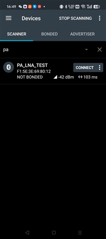

  • Hello Vidar,
    Thanks for your reply.
    It works well.
    CONFIG_LOG=y
    # CONFIG_LOG_BACKEND_UART=y
    CONFIG_USE_SEGGER_RTT=y
    CONFIG_RTT_CONSOLE=y
    CONFIG_UART_CONSOLE=n
    CONFIG_BT=y
    CONFIG_BT_PERIPHERAL=y
    CONFIG_BT_DEVICE_NAME="PA_LNA_TEST"
    CONFIG_MPSL=y
    CONFIG_MPSL_FEM=y
    CONFIG_MPSL_FEM_SIMPLE_GPIO=y
        // SKY85303-21
        nrf_radio_fem: sky_pa-lna {
           compatible = "generic-fem-two-ctrl-pins";
           ctx-gpios = <&gpio0 3 GPIO_ACTIVE_HIGH>;
           crx-gpios = <&gpio0 2 GPIO_ACTIVE_HIGH>;
           ctx-settle-time-us = <10>;
           crx-settle-time-us = <10>;
           tx-gain-db = <4>;
           rx-gain-db = <4>;
    &radio {
        fem = <&nrf_radio_fem>;
