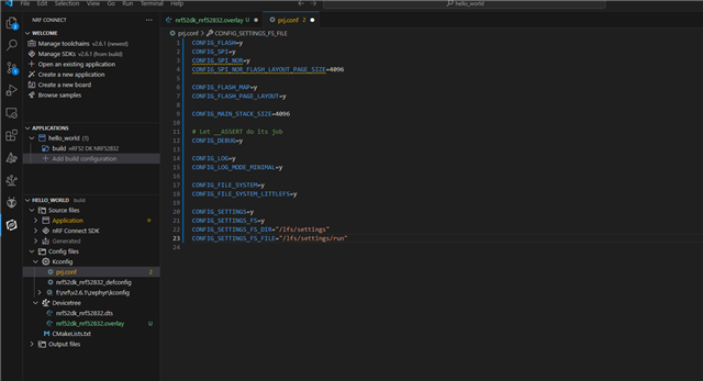

I am trying to implement littlefs in my external flash memory. I am using nrf52832 and try to implement the littlefs sample code.

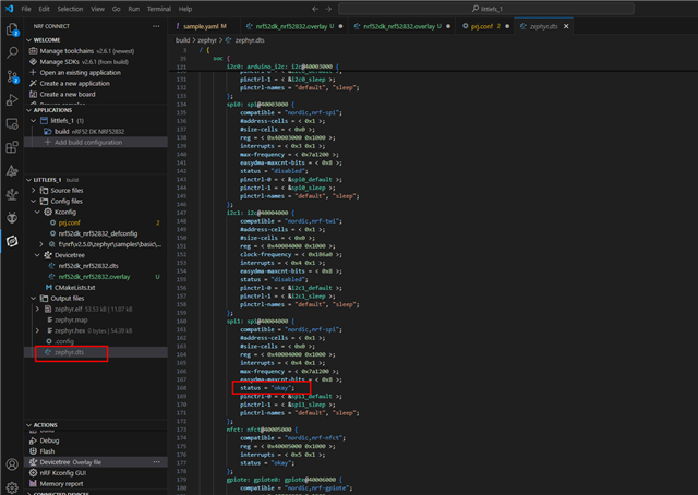

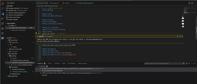

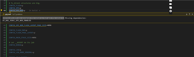

When I am trying to enable Config_spi_nor then I found CONFIG_SPI_NOR was assigned the value y, but got the value n. Could you please help me how I can enable this configuration?

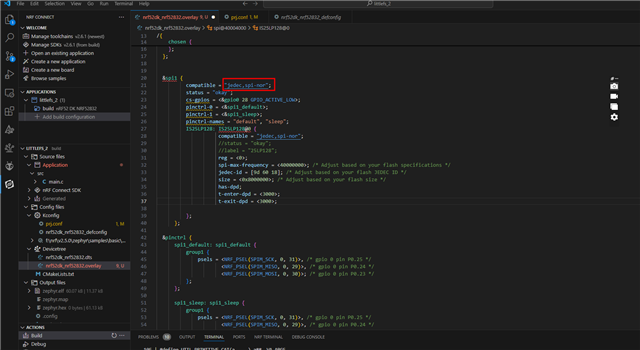

I am also attaching my overlay file and prj file. Please have a look.
Thank you.
Best regards
FSCONFIG_FLASH=y
CONFIG_SPI=y
CONFIG_SPI_NOR=y
CONFIG_SPI_NOR_FLASH_LAYOUT_PAGE_SIZE=4096
CONFIG_FLASH_MAP=y
CONFIG_FLASH_PAGE_LAYOUT=y
CONFIG_MAIN_STACK_SIZE=4096
# Let __ASSERT do its job
CONFIG_DEBUG=y
CONFIG_LOG=y
CONFIG_LOG_MODE_MINIMAL=y
CONFIG_FILE_SYSTEM=y
CONFIG_FILE_SYSTEM_LITTLEFS=y
CONFIG_SETTINGS=y
CONFIG_SETTINGS_FS=y
CONFIG_SETTINGS_FS_DIR="/lfs/settings"
CONFIG_SETTINGS_FS_FILE="/lfs/settings/run"
I also did the same with my hello world sample and getting the same result.
