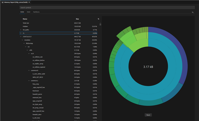

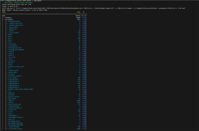

  • I will expand this post when I get back in to work tomorrow. In general my experience is that the zephyr shell can be nice however you have to be careful to include what you need. The CLI is great while testing and learning but I would not include it in a production application.
    However I would just mention that you can use the memory report feature to view ROM, RAM and Partition usage in VScode.
    If you prefer a more CLI then you can use the commands
    west build -t ram_report
    west build -t rom_report
    https://docs.zephyrproject.org/latest/develop/optimizations/tools.html
    Update: Memory view is the way to go in NCS. I checked if there was anything else that I had forgotten to mention but memory view is the way if you don't want to look at the map file itself.
    Its also possible to store the nrf700x patch on external flash if it is needed. We can also try to help you with optimization of the application if needed.

  • Thanks Runar,
    I had seen the Memory Report when I first tried nRF Connect a few months ago, but had completely forgotten about it.  It has been hidden under the Connected Devices panel on my VS Code setup, but no longer.  That is very useful!
    Thank you also for the west commands to generate the reports.  That will also be very useful, for example to diff two different builds and see exactly what changed, or to do a text search.  The reports are very detailed, right down to the function level!

    It is not obvious where the nRF700x patch shows up in the memory map, but I'm guessing that might be the 117,336 byte chunk marked as (hidden).
