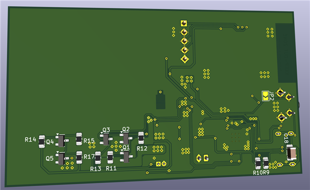

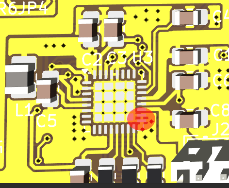

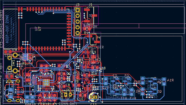

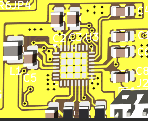

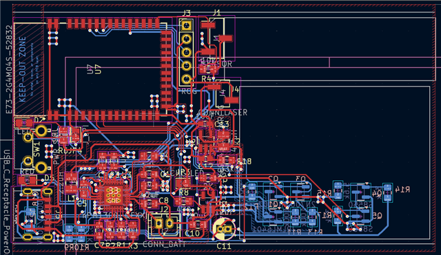

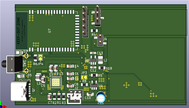

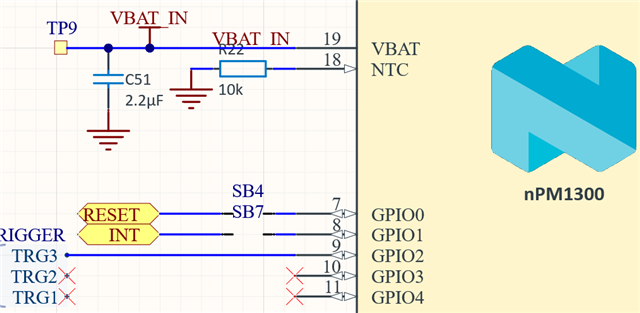

nPM1300 high voltage output at VOUT2 upon VBAT connection.
My lipo battery is at 3.86V and I measured 3.76V at VOUT2 which supplies the nRF52832.

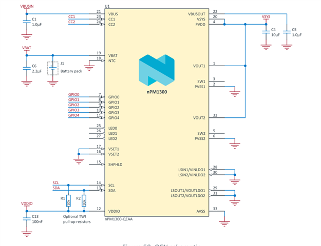

I just based the design in the example circuits in nPM1300 datasheet.
I already reviewed the circuit but I don't see any problem based on example. Based on the VSET2 R it should output 3.3V.
