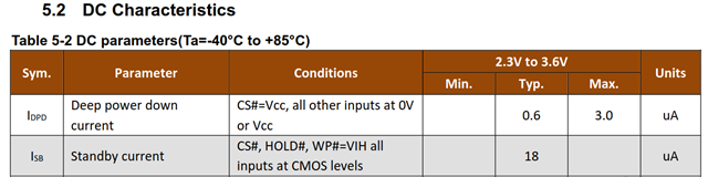

My board (nrf52840 sense) has flash memory P25Q16H. When I put everything off, the board consumes 25uA. To save the last bit of current I would like to put the flash memory to deep sleep.

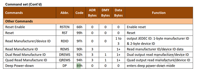

SPI_NOR_CMD_DPD is indeed to 0xB9, which is consistent with the datasheet.
Problem: after executing this command, the power rises to 3.94mA. I have no idea what is causing this.

    My situation is the same except I am using a non-Sense Xiao BLE: approximately 20uA if I do not do anything to power off the external flash, and 2mA if I use pm_device_action_run.
    I did stumble upon a partial solution in this message: https://forum.seeedstudio.com/t/low-power-with-xiao-nrf52840-on-zephyr-rtos/270491/6. By adding flash.* from the zip-file linked to in the message  to my project and executing da_flash_init(); da_flash_command(0xB9); da_flash_uninit();, the power consumption gets down to 2.5uA, which is in line with my expectations.
    So it is possible to get there, and I can use this solution in the short run since I do not need the external flash for my current project, but I would very much prefer a solution that uses Zephyr's power management module.
