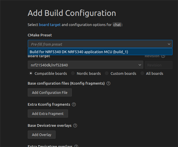

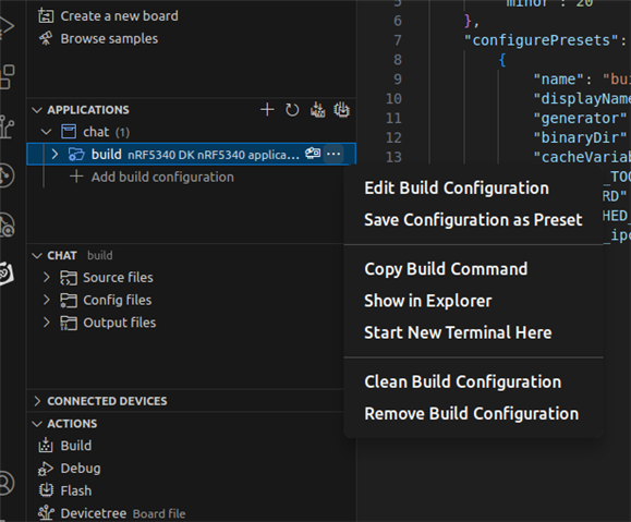

  • Hi
    I'm sorry to hear that. How had you set up your environments? I think the easiest way would be that you on the orignal computer generate a cmake preset file, which you can generate by selecting the save configuration as preset.
    Which will generate a file looking something like this
        "version": 2,
        "cmakeMinimumRequired": {
            "major": 3,
            "minor": 20
        "configurePresets": [
                "name": "build_1",
                "displayName": "Build for NRF5340 DK NRF5340 application MCU",
                "generator": "Ninja",
                "binaryDir": "${sourceDir}/build_1",
                "cacheVariables": {
                    "NCS_TOOLCHAIN_VERSION": "NONE",
                    "BOARD": "nrf5340dk_nrf5340_cpuapp",
                    "CACHED_CONF_FILE": "$env{ZEPHYR_BASE}/../nrf/samples/bluetooth/mesh/chat/prj.conf",
                    "hci_ipc_EXTRA_CONF_FILE": "$env{ZEPHYR_BASE}/../nrf/subsys/bluetooth/mesh/hci_ipc_child_image_overlay.conf;$env{ZEPHYR_BASE}/../nrf/subsys/partition_manager/partition_manager_enabled.conf"
    I normally use git for version control so I would include this file in the version control and exclude the build folder as that is not something you need to transfer to the new computer. On the new computer just download the SDK and extentions as normal. Clone your project from git and open it in VScode.
    When you create a new build configuration you should now see the option to use the Pre-fill from preset
    Regards
    Runar

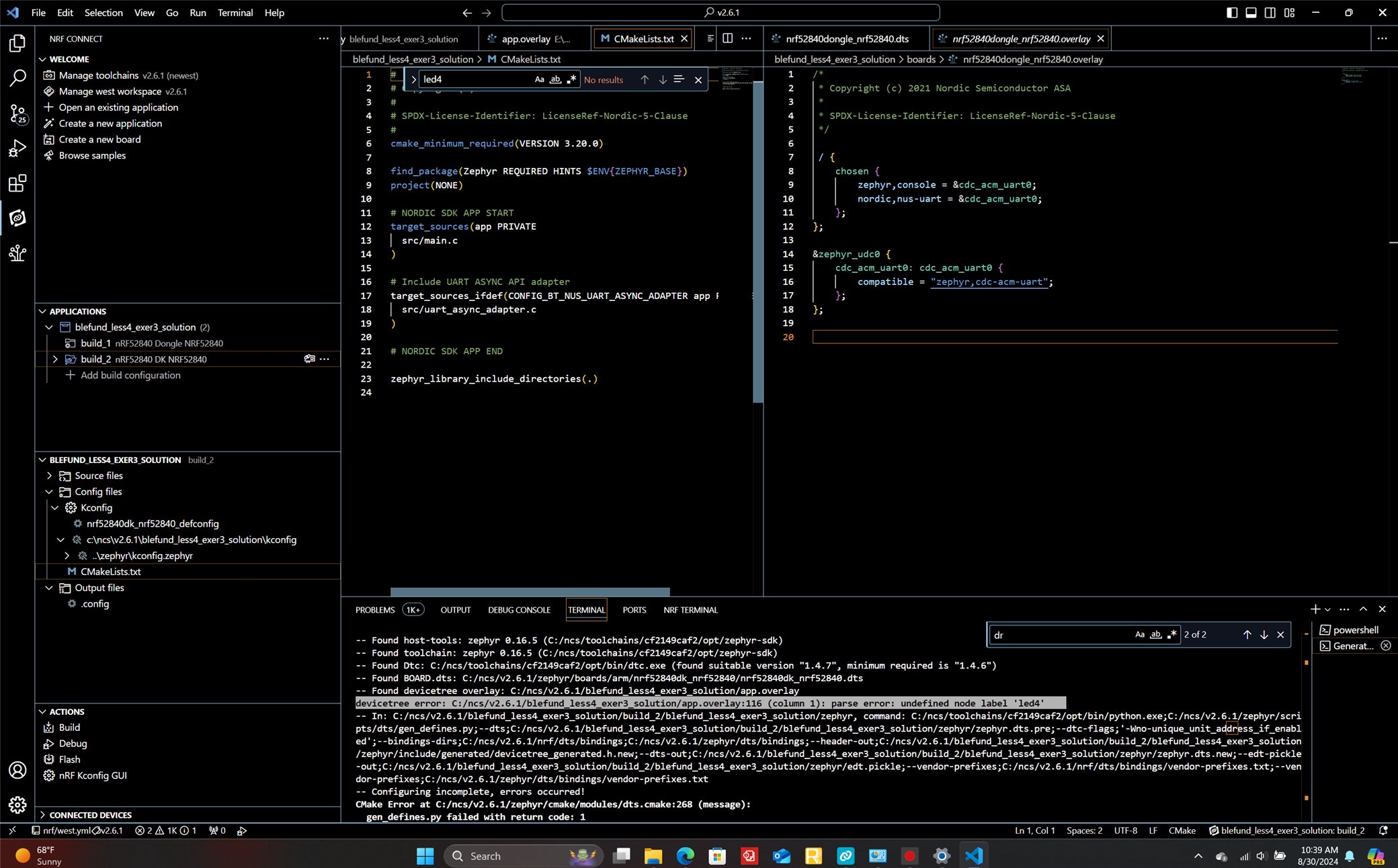

  • Hi Runar,
    Thanks.  That sounds like a good plan.  I will get the GIT stuff working later on (and I have used it on other projects in the past).
    Yesterday, I got my project to compile on my new computer.  I programmed my custom board with the result and, unfortunately, it did not work.  I quickly found that my devices GPIO lines were not operating properly.  The problem was that I had not changed the build configuration from the default 52840 dongle board when I compiled the program.  When I switched over to what I've used before (the nrf52840dk nrf52840) I got error messages saying it had a parsing error with an undefined note label (LED4 -custom pin name used as a GPIO control line).
    When I now look at the config files, I do not see a devicetree at all.  I am confused because I do not know how these files didn't transferred over from the other computer.  I have attached a screenshot showing what I see on my end.  I am uncertain how I should get custom pins into my design.  Didn't I need to use the graphical editor to select the pins?  I can't remember.  Maybe I could just copy the nrf52840dk_nrf52840.dts and app.overlay files over?  I'm confused.

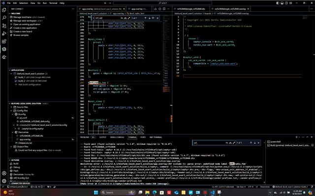

  • So, now I see that there is both of the DeviceTree files in my directory.  I note that I have two errors now of pins that it can't locate: The 'led4' and 'nrf_radio_fem'.  I am not sure why these two are the only troubling ones.  If I remove them, the design compiles but doesn't work (probably because I have taken out these necessary lines
