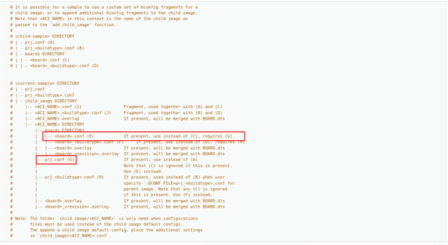

nRF Connect SDK child image per-board configuration discards associated prj.conf in 2.6.1
When building a project using a custom board, as well as both the b0 and mcuboot bootloaders enabled, board-specific child image configuration causes the build system to ignore the project-specific configuration.

The file <wk>/<prj>/child_image/b0/boards/<example>_cpuapp.conf must contain the contents of <wk>/nrf/samples/bootloader/prj.conf and <wk>/nrf/samples/bootloader/boards/nrf5340dk_nrf5340_cpuapp.conf or it will fail to build.
This relates to https://docs.nordicsemi.com/bundle/ncs-2.6.1/page/nrf/config_and_build/multi_image.html#permanent_configuration_changes_to_child_images
and  Compile ERROR "undefined reference to `sys_clock_cycle_get_32'" with custom board
    When the board specific configuration is added, you also need to include the prj.conf (copy of the nrf/samples/bootloader/prj.conf) for the child-image:
    child_image/
    ├── b0
    │   ├── boards
    │   │   └── <example>_cpuapp.conf
    │   └── prj.conf
    ├── mcuboot.conf
    └── mcuboot.overlay

  • While that sounds like it should fix it, I don't see the new file being picked up on a clean build:
    === child image b0 -  begin ===
    Parsing <wk>/zephyr/Kconfig
    Loaded configuration '<wk>/<prj>/boards/arm/<example>/<example>_cpuapp_defconfig'
    Merged configuration '<wk>/<prj>/child_image/b0/boards/<example>_cpuapp.conf'
    Merged configuration '<wk>/nrf/subsys/partition_manager/partition_manager_enabled.conf'
    Merged configuration '<wk>/<prj>/build_mb/b0/zephyr/misc/generated/extra_kconfig_options.conf'
    Configuration saved to '<wk>/<prj>/build_mb/b0/zephyr/.config'
    === child image b0 -  end ===
    I should see a line in there that reads
    Merged configuration '<wk>/<prj>/child_image/b0/prj.conf'
  • This appears to be a caching issue with vscode.  I was able to get a workspace that was failing to pick prj.conf up to pick it up by changing the setting for Configuration to "prj.conf" instead of "Use build system default" when adding a build configuration.
    This was after cloning into a new workspace and everything.  The way vscode caches configuration it has detected is surprising.  Clearing out the automatically generated cmake arguments isn't always sufficient, and deleting a configuration file can break a build.  Seems like this is related to that.
