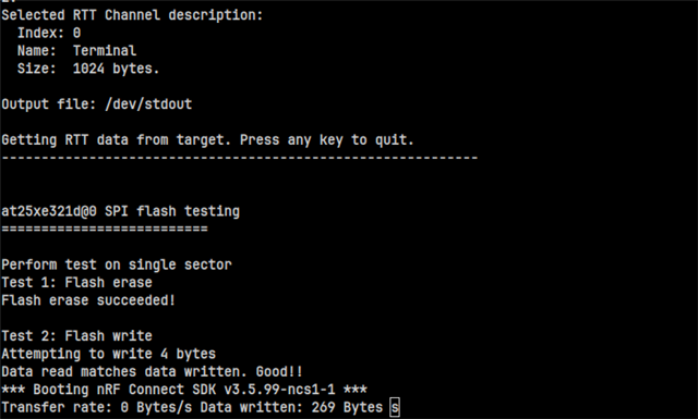

I am developing a Door Lock Matter application using the nRF5340 + AT25XE321D (32Mb SPI-NOR External flash). I am having problems with getting my Matter application to boot using my current configuration. The application throws an FIH_PANIC in this piece of code in bootloader/mcuboot/boot/bootutil/src/loader.c on boot.
I am using nRF Connect SDK v2.6.1.

This is my devicetree definition for the SPI-NOR Flash Device tree:
arduino_spi: &spi4 {
	status = "okay";
	cs-gpios = <&arduino_header 16 GPIO_ACTIVE_LOW>; /* D10 */
	pinctrl-0 = <&spi4_default>;
	pinctrl-1 = <&spi4_sleep>;
	at25xe321d: at25xe321d@0 {
		status = "okay";
		compatible = "jedec,spi-nor";
		reg = < 0 >;
		spi-max-frequency = < 100000000 >;
		hold-gpios = < &gpio0 6 GPIO_ACTIVE_LOW >;
		size = < 0x400000 >;
		has-dpd;
		t-enter-dpd = < 3000 >;
		t-exit-dpd = < 1200000 >;
		jedec-id = [ 1f 47 0c ];

When debugging, the slot variable is 1. So I expect that mcuboot_secondary is failing.
