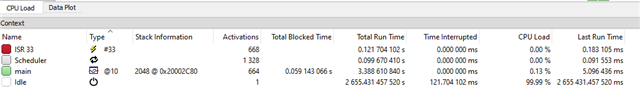

Additionally I verified this code with SEGGER SystemView and all seems to be fine
Did I missed something to make cpu load module working properly?
