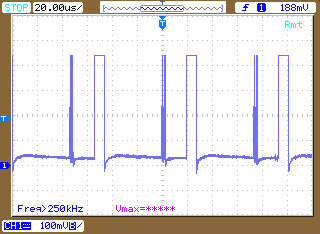

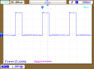

SPI flash not beign found.
Hello, i´m developing on a custom NRF91 board and i´m trying to access the SPI flash memory on it. When i run the code i get the following error:
<err> spi_nor: Device id 00 00 00 does not match config c2 28 17
I´m assuming my flash is not beign properly detected.
Here is my overlay.
&pinctrl {
   spi3_default: spi3_default {
      group1 {
         psels = <NRF_PSEL(SPIM_SCK, 0, 13)>,
                 <NRF_PSEL(SPIM_MISO, 0, 12)>,
                 <NRF_PSEL(SPIM_MOSI, 0, 11)>;
         nordic,drive-mode = <NRF_DRIVE_H0H1>;
   spi3_sleep: spi3_sleep {
      group1 {
         low-power-enable;
&gpio0 {
   status = "okay";
&spi3 {
   status = "okay";
   pinctrl-0 = <&spi3_default>;
   pinctrl-1 = <&spi3_sleep>;
   cs-gpios = <&gpio0 25 GPIO_ACTIVE_LOW>;
   w25q64jw: w25q64jw@0 {
      compatible = "jedec,spi-nor";
      label = "w25q64jw";
      reg = <0>;
      spi-max-frequency = <80000000>;
      jedec-id = [ c2 28 17  ];
      size = <67108864>;
   chosen {
      nordic,pm-ext-flash=&w25q64jw;
The pins of the SPI flash are connected as follows:
MOSI - Pin 19
MISO - Pin 20
SCLK - Pin 23
What could be causing this problem ?
