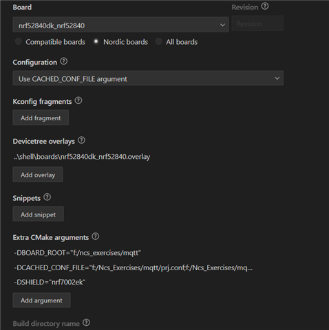

Now I'm trying to get that sample to run on an nRF52840-DK with an nRF7002-EK shield. Here's my attempt at the build configuration:
The truncated extra CMake argument says: -DCACHED_CONF_FILE="f:/Ncs_Exercises/mqtt/prj.conf;f:/Ncs_Exercises/mqtt/boards/shell_prj.conf"
And just off the bottom of that screenshot, "Use sysbuild" is unchecked.
As you can see I have borrowed the .overlay file (without really understanding what it is/does) from the Shell sample. The shell_prj.conf file is one I've manually created by copying the contents of the Shell sample's prj.conf. I have previously had the Shell sample building/running as expected on the 52840-DK + 7002-EK combination. I have also pasted the following extra lines into shell_prj.conf:
CONFIG_L2_WIFI_CONNECTIVITY=y
CONFIG_L2_WIFI_CONNECTIVITY_AUTO_CONNECT=n
CONFIG_L2_WIFI_CONNECTIVITY_AUTO_DOWN=n
Connect SDK version is 2.6.1, and I'm using VS Code.
I suspect what I've described above isn't the right way to go about trying to adapt the sample for this hardware, but for better or worse, it does build, run (briefly) and connect to the wifi. It then reliably crashes and reboots, presumably around the time when it actually tries to test.mosquitto.org. But I'm having a tough time finding out exactly where. Printf-style debugging is not getting me there, and when I try to enable CONFIG_MQTT_HELPER_LOG_LEVEL_DBG, it's frustratingly grayed out.
