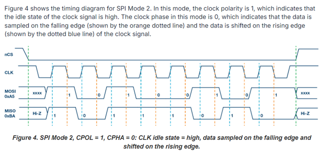

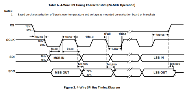

I am using nRF52832 , SDK17, S132, reading a device ID which should be 0x67, I am reading 0x33, than 0x80 ,so it seems to be that the MISO window is getting offseted *
* as 0x67 is 1100111 and 0x33,0x80 is 110011,1000000
There is another device on the bus which I can read (its device ID) correctly, so its very weird.
what can cause this? and how can it be fixed?
Here is the SPI configuration
