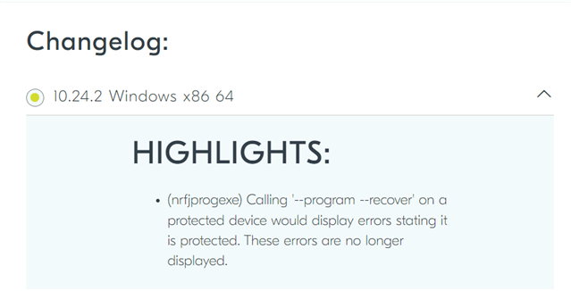

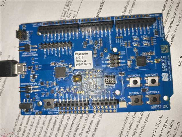

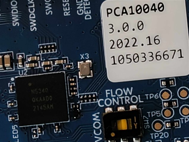

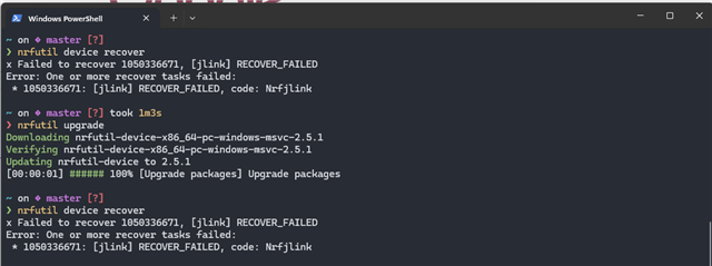

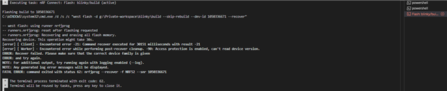

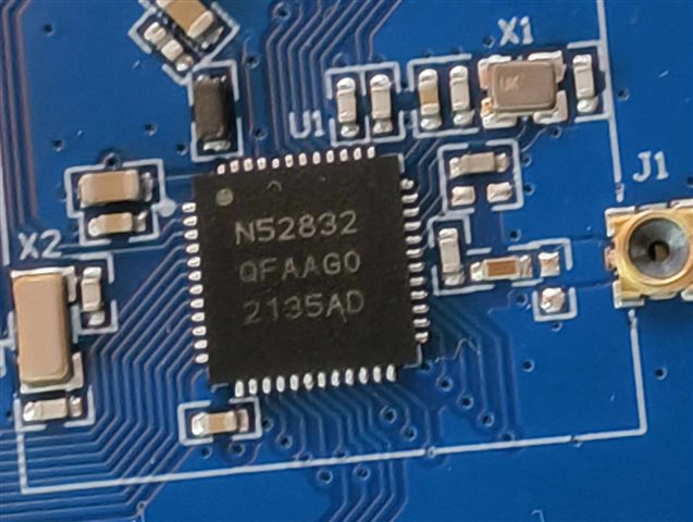

nrf52 cannot recover, error -21 and -90
After getting nrf52 board I've sucessfully recovered it, flashed it with blinky example and I cannot recover it again. I tried doing nrfjprog --recover and nrfjprog --family NRF52, no avail. Here is the log:

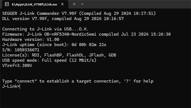

[2024-Aug-29 21:27:37] [trace] [  JLink] - Firmware: J-Link OB-nRF5340-NordicSemi compiled Jul 23 2024 15:26:30
[2024-Aug-29 21:27:37] [trace] [  JLink] - Hardware: V1.00
[2024-Aug-29 21:27:37] [trace] [  JLink] - S/N: 1050336671
[2024-Aug-29 21:27:37] [trace] [  JLink] - OEM: SEGGER
[2024-Aug-29 21:27:37] [trace] [  JLink] - Feature(s): RDI, FlashBP, FlashDL, JFlash, GDB
[2024-Aug-29 21:27:37] [trace] [  JLink] - Bootloader: 2021 May 18
[2024-Aug-29 21:27:37] [trace] [  JLink] - USB speed mode: Full speed (12 MBit/s)

I tried downloading different versions of J-Link and nrf command line tools, tried restarting the board, using different USB ports, restarting my computer and tried trying to recovering it on different computer (Mac and I'm on Windows). The board still runs the blinky code and the recover still doesn't work. In JLink Configurator I also tried to use both "update firmware" and "recover firmware" - nothing.
I also tried using recovering from VSCode addon popup which ran a bit different command (below) but didn't work either.
    Is this nRF52 DK from nordic? Can you please share the chip marking of the device?
    I am just wondering how have you power the board?
    Maybe you can try nrfjprog --eraseall and after that nrfjprog --reecover -f NRF52 --snr 1050336671?
    Have you tried to erase and recover from the programmer app ?
    the board is powered through the micro USB port, connected to a PC. The battery is taken out, but I also tried doing that with battery plugged in and it didn't make a difference. JLink Commander shows VTref = 3.300V
    Code from nrfjprog --eraseall and after that nrfjprog --reecover -f NRF52 --snr 1050336671?
