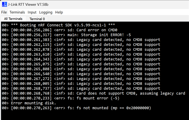

Hi I am trying to get an SD card hooked up to my nrf52840 devkit. I am using nRF Connect v2.6.1 and I was trying to get the sample code working, so I used the sample in ncs/v2.6.1/zephyr/subsys/fs/fs_sample
Unfortunately I get this error when trying to run the program

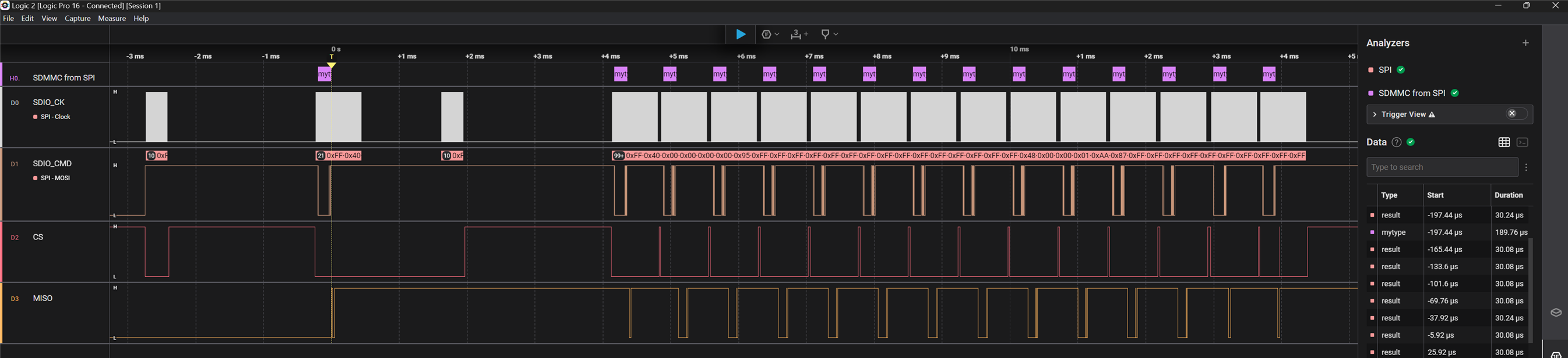

Here's a capture of what the signals look like talking to the SD card over SPI:
Oddly, the CS line is low during the initial "boot up" phase of the device; however, I thought that the CS line is supposed to be held at high voltage level during this initial boot-up? Even if it is used as active low in later communications (as defined here).

  • I updated my board overlay in the following way:
    &spi1 {
        status = "okay";
        cs-gpios = <&gpio0 28 GPIO_ACTIVE_LOW>;
        sdhc0: sdhc@0 {
            compatible = "zephyr,sdhc-spi-slot";
            reg = <0>;
            status = "okay";
            mmc {
                compatible = "zephyr,sdmmc-disk"; # Changed to sdmmc-disk from mmc-disk
                status = "okay";
            spi-max-frequency = <25000000>;
    Changing from "zephyr,mmc-disk" to "zephyr,sdmmc-disk" fixed this issue for me on 2 of my SD cards; however it still does not work on one of my SD cards. I have a Lexar 64GB microSDXC and a SanDisk 64GB microSDXC both formatted with a 30GB Fat32 partition and it works fine. I have a Samsung 32GB microSDHC card and it still fails on this card. This card is not corrupt as I can plug it into a PC and see the files.

    If it helps here is the location where the SPI bus is supposed to set the CS line to active high.
    ncs\v2.6.1\zephyr\drivers\sdhc.c line 127-157:
    static int sdhc_spi_init_card(const struct device *dev)
    	/* SD spec requires at least 74 clocks be send to SD to start it.
    	 * for SPI protocol, this will be performed by sending 10 0xff values
    	 * to the card (this should result in 80 SCK cycles)
    	const struct sdhc_spi_config *config = dev->config;
    	struct sdhc_spi_data *data = dev->data;
    	struct spi_config *spi_cfg = data->spi_cfg;
    	int ret;
    	if (spi_cfg->frequency == 0) {
    		/* Use default 400KHZ frequency */
    		spi_cfg->frequency = SDMMC_CLOCK_400KHZ;
    	/* the initial 74 clocks must be sent while CS is high */
    	spi_cfg->operation |= SPI_CS_ACTIVE_HIGH;
        LOG_DBG("Initializing SPI CS PIN: %d", spi_cfg->cs.gpio.pin);  // I ADDED FOR DEBUGGING
        LOG_DBG("SPI operation flags: %x", spi_cfg->operation);        // I ADDED FOR DEBUGGING
    	ret = sdhc_spi_rx(config->spi_dev, spi_cfg, data->scratch, 10);
    	if (ret != 0) {
    		spi_cfg->operation &= ~SPI_CS_ACTIVE_HIGH;
    		return ret;
    	/* Release lock on SPI bus */
    	ret = spi_release(config->spi_dev, spi_cfg);
    	return ret;
    Now, when running this code I can see the CS active high bit is getting flipped as expected in my log output:
    [00:00:00.267,242] <dbg> sd: sd_init_io: Host controller support 3.3V max
    [00:00:00.267,242] <dbg> sd: sd_init_io: Resetting power to card
    [00:00:00.268,341] <dbg> sdhc_spi: sdhc_spi_init_card: Initializing SPI CS PIN: 28
    [00:00:00.268,371] <dbg> sdhc_spi: sdhc_spi_init_card: SPI operation flags: 7100         // bit 14 is set high
    [00:00:00.268,768] <dbg> sdhc_spi: sdhc_spi_init_card: DONE Initializing SPI CS PIN: 28
    [00:00:00.268,768] <dbg> sdhc_spi: sdhc_spi_init_card: DONE SPI operation flags: 3100    // bit 14 set back to low after init
    [00:00:00.270,996] <dbg> sdhc_spi: sdhc_spi_send_cmd: cmd0 arg 0x0
    [00:00:00.271,728] <dbg> sdhc_spi: sdhc_spi_send_cmd: cmd8 arg 0x1aa
    However when probing the CS line I can see that it is still being treated as active low.

  • I have recently purchased this one and had the same problem. We solved this problem simply by switching to another CS pin and make sure CS pin is active low. Not sure if it will work for you.
