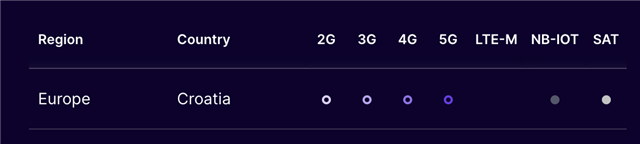

3. I checked the sim im using, and it has nbiot where i currently am situated (Croatia)

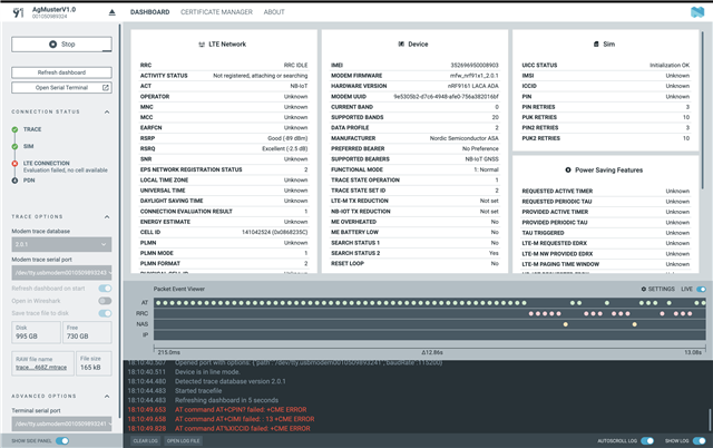

    I've attached the cell monitor screenshot below:
    Also, here is the wireshark PDF - note the "DLInformationTransfer-NB, Attach reject (PLMN not allowed)". Could this be the error? :
    wireshark_sharkfin-gcjnvzvmst8T4NT2.pcapng.pdf
    Any other ideas, please let me know - very much appreciate the help Slight smile

    One of the reasons why i had not explored doing that more was this article: here.
