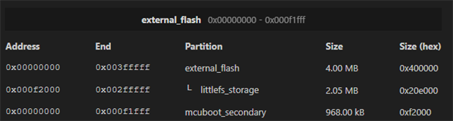

Make storage and mcuboot slot on external flash
I am trying to split the external memory into littlefs storage and mcuboot secondary slot. But I'm not sure what I'm doing right

    There should not be a conflict between using littlefs and secondary slot on external flash, and this look ssensible for me. I would expect that you also have this in a .dts or .overlay file though:
    	chosen {
    		nordic,pm-ext-flash = &mx25r64;
    With that, does it work? If now, in what way does it not work?
  • Should I specify in pm_static like this:
    mcuboot_secondary:
      address: 0x0
      device: DT_CHOSEN(nordic_pm_ext_flash)
      end_address: 0xf2000
      placement:
        align:
          start: 0x4
      region: external_flash
      share_size:
      - mcuboot_primary
    littlefs_storage:
      address: 0xf2000
      end_address: 0x300000
      after:
      - mcuboot_secondary
    external_flash:
      address: 0x300000           <-------------------
      size: 0x100000              <-------------------
    or like this:
    mcuboot_secondary:
      address: 0x0
      placement:
        align:
          start: 0x4
      share_size:
      - mcuboot_primary
    littlefs_storage:
      address: 0xf2000
      after:
      - mcuboot_secondary
    external_flash:
      address: 0x0           <----------------
      size: 0x400000         <----------------
    The first one looks correct. These are separate partitions.
