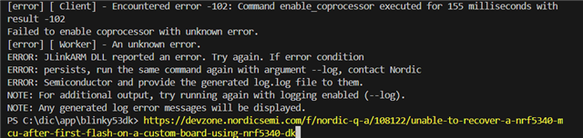

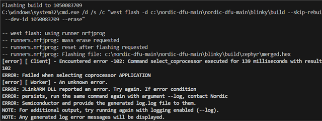

I am using the nRF5340 DK board using its P20 trying to flash an LED blink code to MDBT53-P1M (RAYTAC) I/O shield. The LED is connected to P0.31 of the I/O shield. By following all the instructions given for programming the custom board in the following link: https://docs.nordicsemi.com/bundle/ug_nrf5340_dk/page/UG/dk/ext_programming_support_P20.html
The following is the error log we are getting:

Can anyone guide me over this?

  • Hi
    Yes, I have tried to recover the two cores but don't know what exactly the issue is as I have checked the connection also on the hardware side it seems fine as given in the nRF5340 DK Board Document.
    following are the commands I have used and their error logs:
    [error] [ Client] - Encountered error -102: Command enable_coprocessor executed for 154 milliseconds with result -102
    Failed to enable coprocessor with unknown error.
    [error] [ Worker] - An unknown error.
    ERROR: JLinkARM DLL reported an error. Try again. If error condition
    ERROR: persists, run the same command again with argument --log, contact Nordic
    ERROR: Semiconductor and provide the generated log.log file to them.
    NOTE: For additional output, try running again with logging enabled (--log).
    NOTE: Any generated log error messages will be displayed.
    PS C:\nordic-dfu-main\nordic-dfu-main\blinky> nrfjprog --recover -f NRF53 --snr 1050083709 --coprocessor CP_APPLICATION --speed 1000

    Erasing user code and UICR flash areas.
    Writing image to disable ap protect.
    PS C:\nordic-dfu-main\nordic-dfu-main\blinky> nrfjprog --recover -f nrf53 --coprocessor cp_network
    [error] [ Client] - Encountered error -102: Command enable_coprocessor executed for 155 milliseconds with result -102
    PS C:\nordic-dfu-main\nordic-dfu-main\blinky> :loop
    >> nrfjprog --recover -f nrf52
    >> goto loop
    :loop : The term ':loop' is not recognized as the name of a cmdlet, function, script file, or operable program.
    Check the spelling of the name, or if a path was included, verify that the path is correct and try again.
    At line:1 char:1
    + :loop
        + CategoryInfo          : ObjectNotFound: (:loop:String) [], CommandNotFoundException
        + FullyQualifiedErrorId : CommandNotFoundException
    Recovering device. This operation might take 30s.
    [error] [ Client] - Encountered error -21: Command recover executed for 137 milliseconds with result -21
    ERROR: Recover failed. Please make sure that the correct device family is given
    ERROR: and try again.
    goto : The term 'goto' is not recognized as the name of a cmdlet, function, script file, or operable program.
    At line:3 char:1
    + goto loop
        + CategoryInfo          : ObjectNotFound: (goto:String) [], CommandNotFoundException
    >> goto loop
    At line:1 char:1
    + :loop
    At line:3 char:1
    + goto loop
     *  History restored
  • Have you ever succeeded in flashing or erasing this chip? I am thinking maybe there is not stable power? Also we have seen such reports if the DK was not given stable power and a power spike could have fried the chip.
    Based on the logs you provided, the debugger is unable to communicate in any way to the chip.
  • Hi Susheel,
    Sorry for the delay in response. Yes till now we haven't been able to communicate with the I/O shield for flashing or erasing chip data. So can nRF5340 DK give that power spike to the I/O shield? because the maximum time we are powering up the I/O shield with DK is only using P20.
    on the power consumption when we are powering up the I/O shield with the external power supply we are giving the I/O shield 3v power supply as suggested in the documents and it was drawing the current around 35mA.
  • Hi Susheel,
