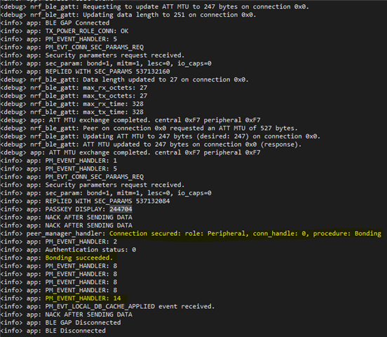

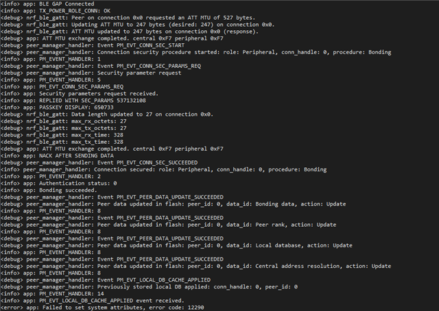

When I try the same thing from my PC through Bluetooth Devices > Add a bluetooth device, I get error BLE_GATTS_EVT_SYS_ATTR_MISSING after it has been paired and bonded to the peripheral. I have tested this with two PCs and it happens the same thing.
In my peer_manager_init() I set MITM with BLE_GAP_IO_CAPS_DISPLAY_ONLY
Any ideas?

case BLE_GAP_EVT_AUTH_KEY_REQUEST:  // THIS IS USED ONLY when: MITM = 1 and I/O Capabilities = Display
            NRF_LOG_DEBUG("BLE_GAP_EVT_AUTH_KEY_REQUEST");
            err_code = sd_ble_gap_auth_key_reply(p_ble_evt->evt.gap_evt.conn_handle, BLE_GAP_AUTH_KEY_TYPE_NONE, passkey);
            if (err_code != NRF_SUCCESS) {NRF_LOG_ERROR("Failed to reply with passkey. Error code: 0x%04x", err_code);}
            else                         {NRF_LOG_INFO("Passkey reply sent successfully.");}
case BLE_GAP_EVT_PASSKEY_DISPLAY:  // THIS IS USED ONLY when: MITM = 1 and I/O Capabilities = Display
        memcpy(passkey, p_ble_evt->evt.gap_evt.params.passkey_display.passkey, 6);
        NRF_LOG_INFO("PASSKEY DISPLAY: %s", passkey);
        // Display the passkey to the user (e.g., on a screen or log)
case BLE_GAP_EVT_AUTH_STATUS:
        NRF_LOG_INFO("Authentication status: %d", p_ble_evt->evt.gap_evt.params.auth_status.auth_status);
        if (p_ble_evt->evt.gap_evt.params.auth_status.auth_status != BLE_GAP_SEC_STATUS_SUCCESS)
            NRF_LOG_ERROR("Bonding failed with status: 0x%x", p_ble_evt->evt.gap_evt.params.auth_status.auth_status);
        else
            NRF_LOG_INFO("Bonding succeeded.");
        err_code = sd_ble_gatts_sys_attr_set(*m_conn_handle_gen, NULL, 0, 0);
            NRF_LOG_ERROR("Failed to set system attributes, error code: %d", err_code);
        else
            NRF_LOG_INFO("System attributes set successfully.");
