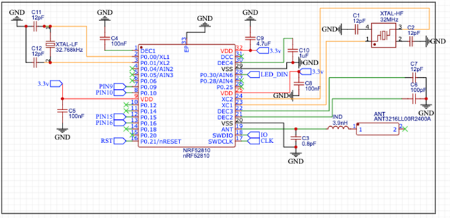

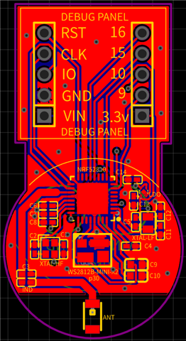

I'm working on a personal project and have designed and printed a small prototype board containing an nrf52810, external antenna, couple of crystals, and a ws2812b onboard, along with a handful of helpful breakout headers for programming and debugging
I can get GPIO working fine (I can toggle offboard leds on demand), and have full control over the ws2812b led, but every single attempt to get a working bluetooth (ble) signal broadcasting is failing. Sometimes the device is stack-overflowing, sometimes it's just erroring out, and sometimes it just ... doesn't say why it's not broadcasting. Note that as far as my circuit goes - I know that it likely isn't great, and won't result in amazing range or anything - I don't mind that as I only need _some_ range so I can test things.
Can someone take a look at the circuit and sample code and give me some insight into why this might not be playing ball? Every time I think it's broadcasting, I can't see the device when I scan using my iPhone and the nrf Connect mobile app.

  • Hi Daniel,
    I am not a hardware engineer, so I would leave out the review part of the hardware for now (Even though a colleague of mine did a quick review and saw that your antenna is not routed correctly as you already mentioned in the original post)
    Stack overflows should not get influence from the hardware layout and schematics issues. I would like to get more details on these errors. What stack overflow are you getting? How often? Can we get some log trace? What is the context of the stack overflow? Is it causing hardfault exception? What does just erroring out mean? Please give more details for us to be able move into proper debugging direction.
  • Thanks for the response - I presume your colleague confirmed that while the routing may not be correct, it would still function (just not very well), yes? I hope so :)
