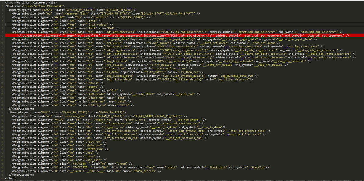

    In the meantime, I would suggest you to start your program in debugger and run it for a while with the setup where nrf_fstorage_is_busy is called from main and always returns true. After running the debugger for a while, please halt the debugger and see if the code is looping in some context. If we can get this context, then we can try to understand why that happens.
  • ANT expert says that it should be fine to use fstorage the way you are using and we are not sure why you are not getting any events. Have you declared NRF_FSTORAGE_DEF in your application?
