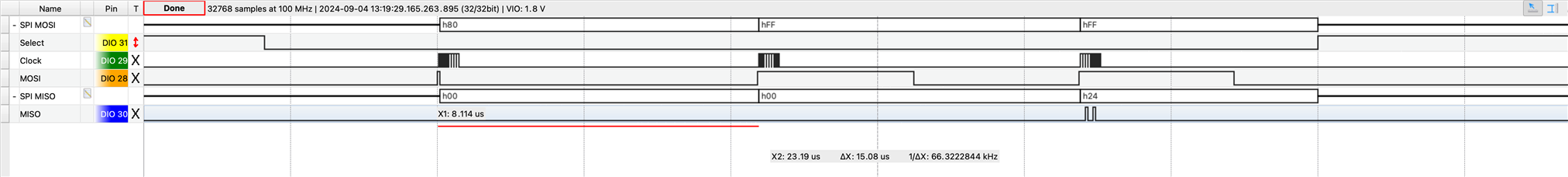

Hi, I am wondering if anyone with SPI expertise can answer this Q, I'm using an nRF52840 with spi_transceive_dt()
In my devicetree I've configured SPIM on SPI3 to talk to a sensor at 10MHz.
I am simply doing a register read to a sensor device. So calling spi_transceive_dt() with 1 Tx byte and 2 Rx bytes (the sensor requires 1 dummy byte for each read). It responds correctly with 0x00, 0x24 and I get the data fine.
I am wondering why is there is big ~14us gap between bytes. From the red line I have highlighted, you can see SCK is just flat, waiting during this time, until it starts to clock again and we see the next byte from the slave (0x00), and then the same gap until the next byte (0x24).
I am wondering if this is to do with the MCU or some inefficiency in the SPI driver somewhere in the stack of nRFX drivers to Zephyr SPI API?

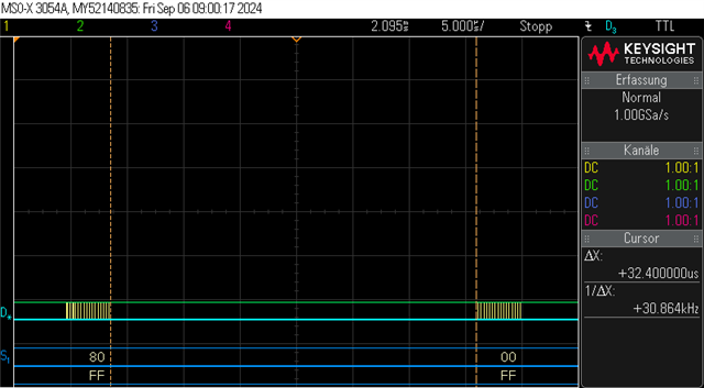

    I think I have found the reason, let me explain.
    I am using SPIM3 set to 8MHz, so any time waiting at this scale looks like quite a lot:
    Look at this function from the zephyr BMI270 driver. It performs a register read from the sensor. It sets up an array of 2 rx_buf structures.
    The rx_buf[0] has 2 bytes length, 1 placeholder for the TX byte (register addr) and then the 1 dummy byte needed when reading from this sensor.
    The rx_buf[1] actually holds the data we want to read, so you see it takes length and pointer to data read.

    On the bus though, we see the large gap is actually between each of these buffers. Once we start it starts long read (rx_buf[1], there are no gaps and it just keeps clocking.
    I tried to illustrate what is going on the bus here below with a single call to bmi270_reg_read_spi where rx_buf[1] len is something like 1000 bytes. You can see the waiting times are between the TX start adress, rx_buf[0] and then rx_buf[1].
    It seems like whenever there is a change in memory buffers, there is this wait time in between. I feel like this is maybe something at the nRFX driver level. I am wondering if this is simply unavoidable overhead setting up the DMA, or some kind of inefficiency.

  • Hi John,
    You are right. When you have multiple arrays/chunks in the buffer the SPI driver will perform multiple SPI transaction. After  each NRFX_SPIM_EVENT_DONE it will move to the next array/chunk.
    I don't see this as a limitation. If you want to have continuous transaction why not just have one single array of 3 bytes and you can ignore the first dummy byte. But I assume it's how the bmi270 driver works. You may consider to re-write the driver if you prefer it the other way. I am not so familiar with the BMI270 so you would need to double check if the latency between the first dummy read byte and the actual read is needed.
