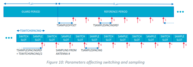

Details of Calculation:
I have read the white paper nWP-036 and understand the antennas are going to be switched in order [0,0,0,0,0,0,0,0] (8 for ref period) followed by [1, 0, 1, 0, ...](sample period). Besides the reference period, I am also using the sample period for calibration since ant0 will be visited again during the sample period.
Here the figure (x-axis: time in us; y-axis: phase in rad) shows how I calculate the phase diff and AoA for a 160us CTE report when using 1M PHY. The red dots are phases of each I/Q data from ant0 during the reference period; and the dots marked as orange stars are the calibrated reference phases, which are prepared for phase difference calculation for each sample from ant1 (yellow dots); calculated phase diff will be shifted by N*2pi to make sure it is within range [-pi, pi]; finally calculated AoA using the arccos formula as the white paper does.
Note that the first sample during the ref period is aligned with time=0, and the first sample during the sample period (first yellow dot) is aligned with time=9 (equals to time of the last ref sample(7us) + TSAMPLESPACINGREF + TSWITCHSPACING/2, according to nWP-036), please correct me if I made any mistake.

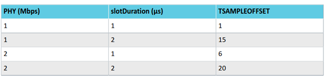

    I digged into direction finding code, and I found something inconsistent between what's defined in NCS and the white paper, you might be interested in this.

    config BT_CTLR_DF_SAMPLE_OFFSET_PHY_1M_SAMPLING_1US
    	int "CTE sampling offset relative for PHY 1M and 1US samples spacing"
    	depends on SOC_COMPATIBLE_NRF
    	range -2048 2047
    	default 1
    	help
    	  Offset of sampling start from beginning of sampling slot. The value is a signed number
    	  of 16M cycles relative. It is used when PHY is set to PHY 1M and sampling slot duration
    	  is 1 us. Decreasing the offset beyond the trigger of the AoA/AoD procedure will have
    	  no effect.
    config BT_CTLR_DF_SAMPLE_OFFSET_PHY_2M_SAMPLING_1US
    	range -2048 2047
    	default 15
    	help
    	  no effect.
    config BT_CTLR_DF_SAMPLE_OFFSET_PHY_1M_SAMPLING_2US
    	int "CTE sampling offset relative for PHY 1M and 2US samples spacing"
    	range -2048 2047
    	default 6
    	help
    	  is 2 us. Decreasing the offset beyond the trigger of the AoA/AoD procedure will have
    	  no effect.
    config BT_CTLR_DF_SAMPLE_OFFSET_PHY_2M_SAMPLING_2US
    	range -2048 2047
    	default 20
    	help
    	  no effect.
    Default values for "BT_CTLR_DF_SAMPLE_OFFSET_PHY_2M_SAMPLING_1US" and "BT_CTLR_DF_SAMPLE_OFFSET_PHY_1M_SAMPLING_2US" in Kconfig.df differ from the white paper (also you should carefully check the comments under 'help'), I wonder which to trust.
    But according to the time shifting caused by TSAMPLEOFFSET as shown in this figure,
    I don't think a wrong value will result in the 180 degree phase difference shifting I mentioned in this post.
