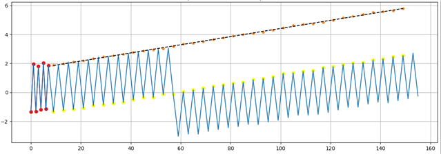

Details of Calculation:
I have read the white paper nWP-036 and understand the antennas are going to be switched in order [0,0,0,0,0,0,0,0] (8 for ref period) followed by [1, 0, 1, 0, ...](sample period). Besides the reference period, I am also using the sample period for calibration since ant0 will be visited again during the sample period.
Here the figure (x-axis: time in us; y-axis: phase in rad) shows how I calculate the phase diff and AoA for a 160us CTE report when using 1M PHY. The red dots are phases of each I/Q data from ant0 during the reference period; and the dots marked as orange stars are the calibrated reference phases, which are prepared for phase difference calculation for each sample from ant1 (yellow dots); calculated phase diff will be shifted by N*2pi to make sure it is within range [-pi, pi]; finally calculated AoA using the arccos formula as the white paper does.
Note that the first sample during the ref period is aligned with time=0, and the first sample during the sample period (first yellow dot) is aligned with time=9 (equals to time of the last ref sample(7us) + TSAMPLESPACINGREF + TSWITCHSPACING/2, according to nWP-036), please correct me if I made any mistake.

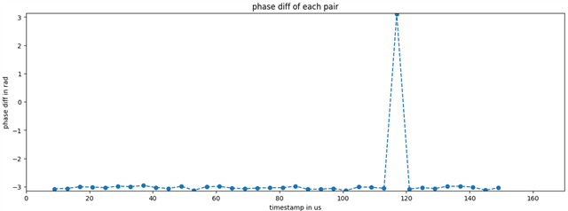

    The 180 degree phase diff shift, that I am asking about in this post, is observed after calculating phase difference for each pair of yellow dot and orange star. There is 180 degree shift for every pair.
    To be more clear, for example if calculating phase difference and aoa of the first yellow dot (Y1) and the first orange star (O1) in plot, it is
    • phase_diff = phase_value_Y1 - phase_value_O1
    • aoa = arccos(phase_diff * wavelength / (2 * PI * pattern_distance))
    If assuming the tx is on the centre line of the two ant patterns of rx,
    • phase_diff should be 0, and then
    • aoa = arccos(0) = PI/2
    In 1M, the actual calculating is exactly like this. However if using 2M, "phase_diff = PI" is what I get.

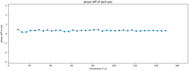

    If plot the phase_diff as below, there is no drift, only some noise. It can also be observed by just looking at the trend of yellow dots and orange stars.

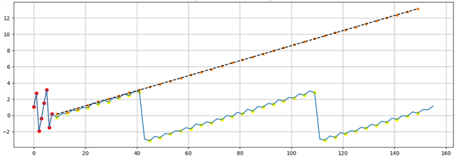

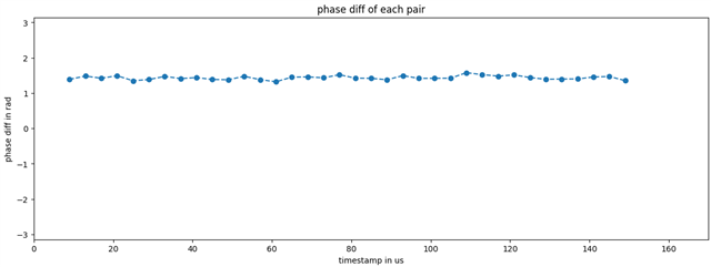

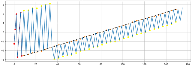

    This post isn't to compare the 1M/2M PHY from the same sampling value. Sorry if it is confusing, I only showed one set of samples with tx running on 1M PHY, and it is just for explaining how I calculate phase diff and AoA using raw data. 2M results was sampled with tx running on 2M BLE PHY in test.
    My point is by following the same calculation method, there will be a PI shift.
    For example, the phase diff is about 1.4 rad under 1M PHY, and then apply the arccos formula you will get correct AoA. But if run sampling using 2M tx again with physical position unchanged, the phase diff you get will be something around -1.74 rad (that is 1.4-PI), and that will lead to wrong AoA result.
    I am asking why there is such a shift, and if there is a mistake in my calculation, please correct me and explain why I can get the correct results for 1M PHY with wrong method. I believe I am exactly following the steps given by white paper.
