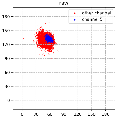

I notice that within each periodic advertising, it contains 5 CTE reports, and channel id of which are N(a random number) followed by 0,0,0,0. And after calculating AoA for each report, I find that the reports with chan_idx=0 are close to each other, however the one that is not 0 has a great bias comparing to the 0 ones.
I wonder if the random channel selecting is actually working or not, because it sounds odd to me that CTE reports within a single periodic advertising train have different BLE channel id.

    So first of all, this seems like a bug somewhere. And the bias you are showing there does make this more evident. Are you using the provided channel IDs when calculating these results, or are you using the presumably correct first channel ID for all the results, both blue and red?
    Elfving
  • Thanks for the update, I appreciate your efforts on finding the solution!

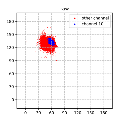

    Yes, I am using the provided channel IDs, so some of the blue dots are claimed to be 0 in (N,0,0,0,0), and some are actually 0 in the case it is (0,0,0,0,0). Here shows plots from the same data set but with channel 5 and 10 highlighted for your reference
    Another strange fact I found is, for this data set, starting from channel 12, the dots tend to gather around two centrals gradually (none of channel 0~11 shows pattern like that, but every in channel 12~36 has the issue), although this might be an unrelated problem, but I will provide some plots just in case you have any thought.
    Note that I also tested other positions, it seems to be a common issue when the channel number increases, only with difference of in which channel you start to notice the separation.
