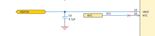

  1. Capacitor connected to VBAT: In the datasheet all reference designs have C6 with 2.2 µF connected to pin VBAT. In the schematic of the EK the capacitor connected to VBAT has 4.7 µF. Why has the EK a different value for C6 compared to what information is provided in the datasheet of the nPM1300?

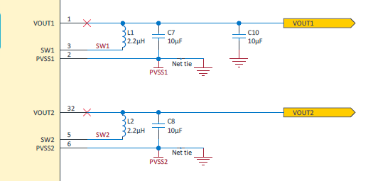

    1. Additional Capacitor at VOUT1 (EK): In the datasheet only one 10 µF capacitor is recommended for VOUT1 (and VOUT2). In the EK I can find two 10 µF capacitors connected to VOUT1. What is the reason for the second capacitor?
    2. Capacitors at EK VOUT1 vs VOUT2: at the EK the pin VOUT1 has two capacitors (as stated above), but VOUT2 only has one capacitor. Where does this difference come from?

  • The capacitor on Vbat isn't critical, both 2.2 µF and 4.7 µF is ok here.
    The second capacitor is connected to the main ground plane where the first is grounded near the PVVS1 pin. C10 is optional. As long as you don't exceed 30 µF, most is ok. Too much capacitance will cause the inrush current to exceed the default VBUS current of 100 mA.
