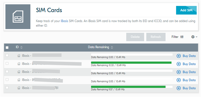

From the logs, it always generated even "CLOUD_EVT_CONNECTION_TIMEOUT", but I don't see any error or warning.
Could the cloud service not have much time to connect because LTE cell updates keep interrupting? Or low Signal quality? But I'm not sure, since I'm just a beginner.
I need help on this. How do I check where the issue is?
Is there a command or logs I can enable to check the real reason behind this?

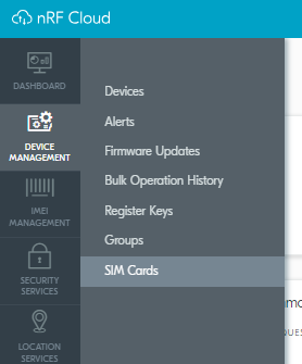

I checked the network status, and certificates (AT%CMNG), and they are all there, the device is registered on of cloud as well (as a few days ago it was sending data, and its sim and cloud limit is not been reached yet), but shows no data as its not connecting.
Any help or suggestion would be highly appreciated.
