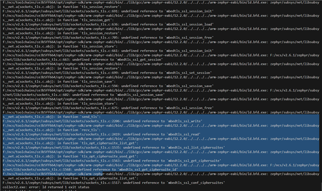

CONFIG_NET_SOCKETS_SOCKOPT_TLS generate build errors when build with nrf9160_ns image
I am using nrf9160.
When I use build flag CONFIG_NET_SOCKETS_SOCKOPT_TLS with build configuration of nrf9160dk_nrf9160 the build is fine.
But when I use nrf9160dk_nrf9160_ns the build fails if CONFIG_NET_SOCKETS_SOCKOPT_TLS is enabled.

ERROR
