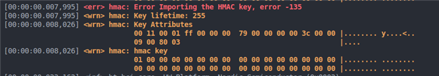

I have been using the PSA crypto APIs successfully with volatile keys till now.
We want to move on to using persistent keys but I am not able to import a persistent key. I receive an error -135.
Here's my configuration. The build target is a _ns application.

The code I am using to import a persistent key.
psa_status_t hmac_import_key(
    psa_key_lifetime_t key_lifetime,
    const uint8_t* hmac_key,
    uint8_t hmac_key_size)
    psa_status_t status = PSA_SUCCESS;
    psa_key_attributes_t key_attributes = PSA_KEY_ATTRIBUTES_INIT;
    if (hmac_key_size != HMAC_SIG_SIZE_BYTES)
        LOG_ERR("Invalid HMAC key size");
        status = PSA_ERROR_GENERIC_ERROR;
    if (status == PSA_SUCCESS)
        // set import key parameters
        psa_set_key_usage_flags(
            &key_attributes,
            PSA_KEY_USAGE_VERIFY_HASH | PSA_KEY_USAGE_SIGN_HASH);
        psa_set_key_algorithm(
            &key_attributes,
            PSA_ALG_HMAC(PSA_ALG_SHA_256));
        psa_set_key_lifetime(
            &key_attributes,
            key_lifetime);
        psa_set_key_type(
            &key_attributes,
            PSA_KEY_TYPE_HMAC);
        psa_set_key_bits(
            &key_attributes,
            HMAC_KEY_LENGTH_BITS);
        if (key_lifetime == PSA_KEY_PERSISTENCE_READ_ONLY)
            psa_set_key_id(
                &key_attributes,
                121);
        if (key_lifetime == PSA_KEY_LIFETIME_VOLATILE)
            LOG_HEXDUMP_INF(
                hmac_key,
                32,
                "Importing volatile debug HMAC key");
        // Import key
        status = psa_import_key(
            &key_attributes,
            hmac_key,
            hmac_key_size,
            &g_hmac_key_info.key_id);
While importing a debug key I see this at the application log
And I see this on the secure thread log
    I don't see all of your hmac_import_key() function. Is it from psa_import_key() you get PSA_ERROR_INVALID_ARGUMENT or somewhere else? What exactly are the input arguments?
    From the API doc:
    PSA_ERROR_INVALID_ARGUMENT - The following conditions can result in this error:
    • The key type is invalid.
    • The key size is nonzero, and is incompatible with the key data in data.
    • The key lifetime is invalid.
    • The key identifier is not valid for the key lifetime.
    • The key usage flags include invalid values.
    • The key’s permitted-usage algorithm is invalid.
    • The key attributes, as a whole, are invalid.
    • The key data is not correctly formatted for the key type.
