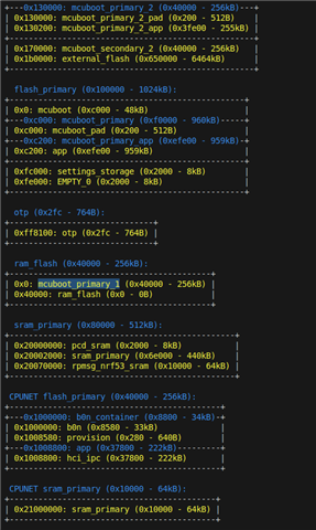

And here are the relevant error messages:
-- Found partition manager static configuration: C:/Users/foo/Documents/GitHub/foo/pm_static.yml
Partition 'settings_storage' is not included in the dynamic resolving since it is statically defined.
Partition 'mcuboot_primary' is not included in the dynamic resolving since it is statically defined.
Partition 'mcuboot_secondary' is not included in the dynamic resolving since it is statically defined.
Partition manager failed: End of last partition is after last valid address
Failed to partition region flash_primary, size of region: 1048576
Partition Configuration:
custom_nvs_storage:
mcuboot:
  placement: {}
mcuboot_pad:
  placement:
    before:
    - mcuboot_primary_app
settings_storage:
And here are the project configs in case that helps you:

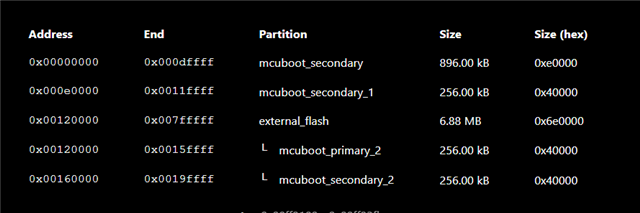

    Thank you for your reply. I have followed the link you provided, and also the documentation I found here: https://docs.nordicsemi.com/bundle/ncs-latest/page/nrf/app_dev/bootloaders_dfu/qspi_xip_split_image.html
    I seem to have encountered a new problem however, in that
    CONFIG_XIP_SPLIT_IMAGE=y
    Is not recognized.
    warning: attempt to assign the value 'y' to the undefined symbol XIP_SPLIT_IMAGE
    error: Aborting due to Kconfig warnings
    Is this an issue because we are using 2.5.0?
    As a further experiment, I tried commenting out just that line and rebuilding. I get a different error, instead I see:
    [206/618] Building C object zephyr/subsys/mgmt/mcumgr/grp/img_mgmt/CMakeFiles/subsys__mgmt__mcumgr__grp__img_mgmt.dir/src/zephyr_img_mgmt.c.obj
    FAILED: zephyr/subsys/mgmt/mcumgr/grp/img_mgmt/CMakeFiles/subsys__mgmt__mcumgr__grp__img_mgmt.dir/src/zephyr_img_mgmt.c.obj
    C:\ncs\toolchains\c57af46cb7\opt\zephyr-sdk\arm-zephyr-eabi\bin\arm-zephyr-eabi-gcc.exe -DADC_BATTERY_CHANNEL=5 -DADC_EXTERNAL_DIVIDER=2 -DARM_ALL_FAST_TABLES -DARM_DSP_CONFIG_TABLES -DARM_FAST_ALLOW_TABLES -DARM_FFT_ALLOW_TABLES -DARM_TABLE_RECIP_Q15 -DARM_TABLE_RECIP_Q31 -DARM_TABLE_SIN_F32 -DARM_TABLE_SIN_Q15 -DARM_TABLE_SIN_Q31 -DCENTER_CURSOR_ON_INACTIVITY_FLAG -DCPU_NRF5340=1 -DDEVICE_NAME_STRING="\"Glasses PCB\"" -DHEAD_MOVEMENT_THRESHOLD=1 -DKERNEL -DNRF5340_XXAA_APPLICATION -DNRF_SKIP_FICR_NS_COPY_TO_RAM -DN_ACTIVE_CHANNELS=4 -DPD_CHANNEL_ONEHOT=0x33 -DSCROLL_OFFSET=0 -DUSE_PARTITION_MANAGER=1 -DUSING_DEV_KEY -DZCBOR_ASSERTS -D_ANSI_SOURCE -D_FORTIFY_SOURCE=1 -D__LINUX_ERRNO_EXTENSIONS__ -D__PROGRAM_START -D__ZEPHYR__=1 -IC:/ncs/v2.5.0/zephyr/subsys/mgmt/mcumgr/grp/img_mgmt/include -IC:/ncs/v2.5.0/zephyr/include -Izephyr/include/generated -IC:/ncs/v2.5.0/zephyr/soc/arm/nordic_nrf/nrf53 -IC:/ncs/v2.5.0/zephyr/lib/libc/newlib/include -IC:/ncs/v2.5.0/zephyr/soc/arm/nordic_nrf/common/. -IC:/ncs/v2.5.0/zephyr/subsys/mgmt/mcumgr/util/include -IC:/ncs/v2.5.0/bootloader/mcuboot/boot/bootutil/include -IC:/ncs/v2.5.0/zephyr/subsys/mgmt/mcumgr/transport/include -IC:/ncs/v2.5.0/bootloader/mcuboot/boot/zephyr/include -IC:/ncs/v2.5.0/zephyr/subsys/bluetooth -IC:/ncs/v2.5.0/zephyr/subsys/settings/include -IC:/ncs/v2.5.0/nrf/include -IC:/ncs/v2.5.0/nrf/tests/include -IC:/ncs/v2.5.0/modules/hal/cmsis/CMSIS/Core/Include -IC:/ncs/v2.5.0/modules/hal/cmsis/CMSIS/DSP/Include -IC:/ncs/v2.5.0/zephyr/modules/cmsis/. -IC:/ncs/v2.5.0/modules/hal/nordic/nrfx -IC:/ncs/v2.5.0/modules/hal/nordic/nrfx/drivers/include -IC:/ncs/v2.5.0/modules/hal/nordic/nrfx/mdk -IC:/ncs/v2.5.0/zephyr/modules/hal_nordic/nrfx/. -Imodules/libmetal/libmetal/lib/include -IC:/ncs/v2.5.0/modules/lib/open-amp/open-amp/lib/include -IC:/ncs/v2.5.0/modules/crypto/tinycrypt/lib/include -IC:/ncs/v2.5.0/modules/lib/zcbor/include -IC:/ncs/v2.5.0/nrfxlib/softdevice_controller/include -IC:/ncs/v2.5.0/bootloader/mcuboot/boot/bootutil/zephyr/.. -IC:/ncs/v2.5.0/bootloader/mcuboot/boot/bootutil/zephyr/../include -IC:/ncs/v2.5.0/bootloader/mcuboot/boot/bootutil/zephyr/../../zephyr/include -isystem C:/ncs/v2.5.0/nrfxlib/crypto/nrf_cc312_platform/include -Wshadow -fno-strict-aliasing -Os -imacros C:/Users/foo/Documents/GitHub/foo_V4/Earbud_V4_5/zephyr/include/generated/autoconf.h -fno-common -g -gdwarf-4 -fdiagnostics-color=always -mcpu=cortex-m33 -mthumb -mabi=aapcs -mfpu=fpv5-sp-d16 -mfloat-abi=hard -mfp16-format=ieee --sysroot=C:/ncs/toolchains/c57af46cb7/opt/zephyr-sdk/arm-zephyr-eabi/arm-zephyr-eabi -imacros C:/ncs/v2.5.0/zephyr/include/zephyr/toolchain/zephyr_stdint.h -Wall -Wformat -Wformat-security -Wno-format-zero-length -Wno-pointer-sign -Wpointer-arith -Wexpansion-to-defined -Wno-unused-but-set-variable -Werror=implicit-int -fno-pic -fno-pie -fno-asynchronous-unwind-tables -fno-reorder-functions --param=min-pagesize=0 -fno-defer-pop -fmacro-prefix-map=C:/Users/foo/Documents/GitHub/foo_V4=CMAKE_SOURCE_DIR -fmacro-prefix-map=C:/ncs/v2.5.0/zephyr=ZEPHYR_BASE -fmacro-prefix-map=C:/ncs/v2.5.0=WEST_TOPDIR -ffunction-sections -fdata-sections -specs=nano.specs -std=c99 -MD -MT zephyr/subsys/mgmt/mcumgr/grp/img_mgmt/CMakeFiles/subsys__mgmt__mcumgr__grp__img_mgmt.dir/src/zephyr_img_mgmt.c.obj -MF zephyr\subsys\mgmt\mcumgr\grp\img_mgmt\CMakeFiles\subsys__mgmt__mcumgr__grp__img_mgmt.dir\src\zephyr_img_mgmt.c.obj.d -o zephyr/subsys/mgmt/mcumgr/grp/img_mgmt/CMakeFiles/subsys__mgmt__mcumgr__grp__img_mgmt.dir/src/zephyr_img_mgmt.c.obj -c C:/ncs/v2.5.0/zephyr/subsys/mgmt/mcumgr/grp/img_mgmt/src/zephyr_img_mgmt.c
    In file included from C:/ncs/v2.5.0/zephyr/include/zephyr/toolchain.h:50,
                     from C:/ncs/v2.5.0/zephyr/include/zephyr/kernel_includes.h:19,
                     from C:/ncs/v2.5.0/zephyr/include/zephyr/kernel.h:17,
                     from C:/ncs/v2.5.0/zephyr/subsys/mgmt/mcumgr/grp/img_mgmt/src/zephyr_img_mgmt.c:7:
    C:/ncs/v2.5.0/zephyr/include/zephyr/toolchain/gcc.h:81:36: error: static assertion failed: "Missing partitions?"
       81 | #define BUILD_ASSERT(EXPR, MSG...) _Static_assert(EXPR, "" MSG)
    C:/ncs/v2.5.0/zephyr/subsys/mgmt/mcumgr/grp/img_mgmt/src/zephyr_img_mgmt.c:44:1: note: in expansion of macro 'BUILD_ASSERT'
       44 | BUILD_ASSERT(FIXED_PARTITION_EXISTS(SLOT4_PARTITION) &&
    [214/618] Building C object zephyr/subsys/fs/CMakeFiles/subsys__fs.dir/fs.c.obj
    FATAL ERROR: command exited with status 1: 'C:\ncs\toolchains\c57af46cb7\opt\bin\cmake.EXE' --build 'c:\Users\foo\Documents\GitHub\foo_V4\Earbud_V4_5'
    My relevant files at this point:
    Added to prj.config:
    #XIP
    CONFIG_NORDIC_QSPI_NOR=y
    CONFIG_CODE_DATA_RELOCATION=y
    CONFIG_HAVE_CUSTOM_LINKER_SCRIPT=y
    CONFIG_BUILD_NO_GAP_FILL=y
    CONFIG_XIP=y
    CONFIG_NORDIC_QSPI_NOR_XIP=y
    # CONFIG_XIP_SPLIT_IMAGE=y
    CONFIG_CUSTOM_LINKER_SCRIPT="linker_file_for_relocation.ld"
    CONFIG_UPDATEABLE_IMAGE_NUMBER=3
    CONFIG_FLASH_INIT_PRIORITY=40
    Added to mcuboot prj.config
    CONFIG_BOOT_MAX_IMG_SECTORS=256
    CONFIG_PARTITION_MANAGER_ENABLED=y
    CONFIG_XIP=y
    CONFIG_BOOT_DIRECT_XIP=y
    PM_Static.yml, almost exactly like this link here for XIP with no network core support but I added a little partition for my own code to use
    app:
      address: 0x10200
      end_address: 0x7a000
      region: flash_primary
    external_flash:
      address: 0x120000
      device: MX25R64
      end_address: 0x800000
      region: external_flash
    mcuboot:
      address: 0x0
      end_address: 0x10000
    mcuboot_pad:
      address: 0x10000
      end_address: 0x10200
    mcuboot_primary:
      address: 0x10000
      orig_span: &id001
      - mcuboot_pad
      - app
      span: *id001
    mcuboot_primary_app:
      address: 0x10200
      orig_span: &id002
      - app
      span: *id002
    mcuboot_secondary_pad:
      address: 0x7a000
      end_address: 0x7a200
    mcuboot_secondary:
      address: 0x7a000
      end_address: 0xe4000
      orig_span: &id003
      - mcuboot_secondary_pad
      - mcuboot_secondary_app
      span: *id003
    mcuboot_secondary_app:
      address: 0x7a200
    EMPTY_3:
      address: 0xe4000
      end_address: 0x100000
    mcuboot_primary_1:
      address: 0x120000
      device: external_flash
      end_address: 0x160000
      orig_span: &id004
      - mcuboot_primary_1_pad
      - mcuboot_primary_1_app
      span: *id004
    mcuboot_primary_1_pad:
      address: 0x120000
      end_address: 0x120200
    mcuboot_primary_1_app:
      address: 0x120200
      device: MX25R64
    mcuboot_secondary_1:
      address: 0xd4000
      device: MX25R64
      end_address: 0x114000
    EMPTY_1:
      address: 0x0
      device: MX25R64
      end_address: 0xd4000
    EMPTY_2:
      address: 0x114000
      device: MX25R64
      end_address: 0x120000
    otp:
      address: 0xff8100
      end_address: 0xff83fc
      region: otp
    rpmsg_nrf53_sram:
      address: 0x20070000
      end_address: 0x20080000
      placement:
        before:
        - end
      region: sram_primary

      I have changed my pm_static to exactly match the example, other than my added partition for my code to store stuff:
    app:
        address: 0x10200
    external_flash:
        address: 0x120000
        device: MX25R64

    mcuboot_secondary:
        address: 0x0
        device: MX25R64
        end_address: 0xe0000
        address: 0xe0000
        device: MX25R64
    mcuboot_primary_2:
        address: 0x120000
        device: MX25R64
    mcuboot_secondary_2:
        address: 0x160000
        device: MX25R64
        end_address: 0x1a0000

    Thanks for your continued assistance
    The assert is raised because the emulated mcuboot_primary_1 partition in ram is not enabled in kconfig. Please try adding CONFIG_NRF53_UPGRADE_NETWORK_CORE=y to your project configuration file (prj.conf). Please also note that in SDK v2.7.0 the project must be built without sysbuild enabled.
    Vidar

  • Thanks for all of your help, I think we are almost there. I switched to the secure instead of ns, and that seems to have resolved the final error I was getting and it now builds. Is there anything else I should be aware of for having made this change?
    Looking at my output, I notice that my EXTFLASH is actually quite small:
    [590/608] Linking CXX executable zephyr\zephyr.elf
    Memory region         Used Size  Region Size  %age Used
            EXTFLASH:         360 B     261632 B      0.14%
               FLASH:      712056 B     916992 B     77.65%
                 RAM:      124488 B       440 KB     27.63%
            IDT_LIST:          0 GB        32 KB      0.00%
    Looking at the memory report, it seems the problem is just that the partitions need to be made bigger in pm_static.yml.
    Do I just need to make mcuboot_primary_2 and mcuboot_secondary_2 larger?
