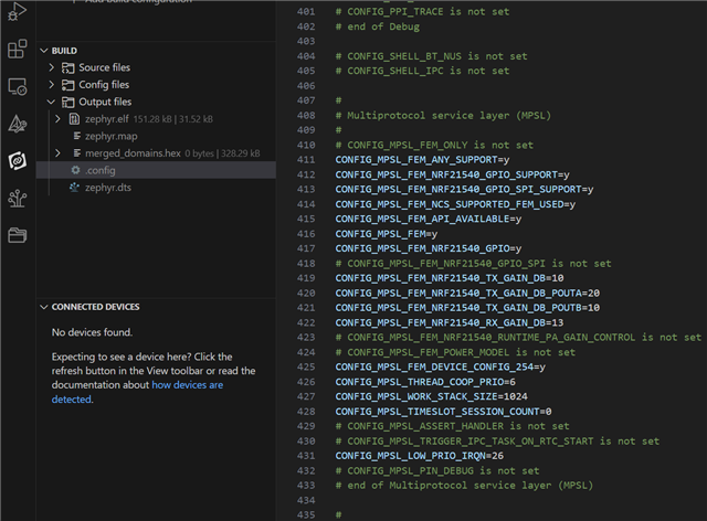

I have a BLE project using the nRF5340-DK and I wanted to use the nRF21540-EK for increasing range. My plan is to connect the SWF connector to the nRF21540-EK using Murata
MXHS83QE3000 cable.
How can I configure my project to be used with the FEM? What project files will need to be modified and what modifications are required so that the FEM TX and RX path enablement is synced with the BLE radio of the nRF5340? Are there any examples?
I found this page but it wasn't very helpful
